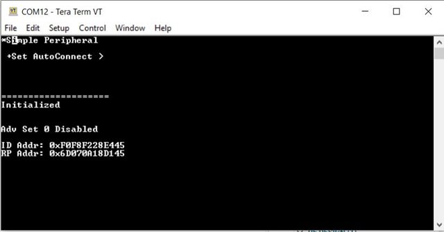

I am working with the simple peripheral example in the launchpad and on setting the “Legacy Event Properties Options” to "Connectable and scannable undirected" in simple_peripheral.syscfg file, a device address is displayed on the terminal as shown in figure 1 and the device is detectable by other BLE device.
On shifting it to “Non-connectable and Non-scannable undirected” mode no address is displayed on the terminal as shown in figure 2 and also other BLE devices are not able to detect it.
I want to calculate how many packets were received by a central device in a particular time from a broadcaster in given time and for that I need to identify the broadcaster.

  • Hi Garvit,
    When using non-scannable advertisements, the device will not send scan responses. If the central device uses the scan response to identify nearby devices then it will not be able to detect it.The scanner should instead look for advertisements themselves and not the scan responses.
    Jan

    I modified the temp16 to temp16 = SCAN_FLT_PDU_NONCONNECTABLE_ONLY | SCAN_FLT_PDU_COMPLETE_ONLY;
    The issue I am facing now are -
    1) How to modify simple_peripheral code to assign the device a address in non-connectable and non-scannable mode? Even if  the simple_central project is scanning for non-connectable advertisement it would need some way to identify the device but currently simple_peripheral is not assigning any address to device in this mode.
    2) On modifying the simple_central code it is entering in the error.c file at following location and stops execution.
    Garvit
  • Hi Garvit,
    I believe the simple_peripheral project still has an address (even if its not being printed), so we can identify which is the correct device if we modify the simple_peripheral code to print out the address or if we add some unique advertising data that we can look for on the simple_central side. Do you have access to a bluetooth sniffer? If so, then this will help us figure out if we are sending out the packets properly.

  • Hi Garvit,
    I am a bit confused by your last comment. To clarify, you are no longer seeing the error code you were before, but now you are getting an error sound from your PC (originating from your UART terminal) when the program is running? Can you specify the Serial settings you have configured your UART terminal with do you have any output on the screen you can share?
