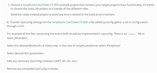

We are working on migrating an old project from CC2640R2F to CC2340R5.
In C:\ti\simplelink_cc2640r2_sdk_3_40_00_10\source\ti\ble5stack\boards\CC2640R2DK_4XS\Board.h, we could see these PINs defined:
But we don't know how to define these PINs in CC2340R5.
There wouldn't be a Board.h file in this example as this document has stated.
Then, how should we do what Board.h has done in our CC2340R5 project?

    The pin instances (now called GPIOs on CC23xx devices) are generated by SysConfig.
    You should use SysConfig to define the GPIOs instances you need.

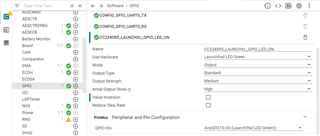

    Does that mean I shall put those defined items like this?
    I took "
    /* GPIO */
    #define CC2640R2_LAUNCHXL_GPIO_LED_ON 1" for example.
    If the above setting is correct,
    Then, if I would like to define "
    /* Discrete Inputs */
    #define CC2640R2_LAUNCHXL_PIN_BTN1              IOID_13
    ", what should I set in column "GPIO pin"?
    Thanks.
    BR,
    The symbol "CC2640R2_LAUNCHXL_GPIO_LED_ON" is rather used to describe a GPIO level (i.e. 1 or 0). I don't think it makes sense to define it with SysConfig this way.
    For the symbol "CC2640R2_LAUNCHXL_PIN_BTN1", you should define a GPIO instance "CC2340R5_PIN_BTN1" (or different name, this is up to you).
    You can take the drivers example (especially the gpiointerrupt example when you are dealing with buttons) as model:
    Similarly, if you wish to define a UART, I2C, SPI, ADC, etc., you can use the corresponding drivers example stored in <SDK>\examples\rtos\LP_EM_CC2340R5\drivers
    I hope this will help,
    Thanks for the advice!
    1. I still wonder what it should be like in CC2340R5 if I originally had "/* GPIO */
    #define CC2640R2_LAUNCHXL_GPIO_LED_ON 1" in CC2640R2F's source codes?
    2. What about the PinMux part? What should I set in "GPIO pin"? What exactly pin will it be controlling if I set it to "Any"?
    Thanks.
    BR,
    1- Again, xxx_LED_ON only holds a logical level, so you can do something like:
    #define CC2340R5_LAUNCHXL_GPIO_LED_ON 1
    2- The "PinMux" allows you to physically connect a GPIO pin to the newly created GPIO instance. Selecting "Any" tells SysConfig to find any pin available. If this is not suitable for you, i.e. if you prefer to select a specific pin number, make sure to select it using the drop-down list.
    Also, make sure to notice the field "Use Hardware". This field is particularly helpful when using a TI LaunchPad as it directly tells SysConfig to use the pins where the physical peripherals (e.g. buttons and LEDs) are routed. In case you are not using a TI LaunchPad, it might be wise to set the "Use Hardware" field to "None".
    To finish, I recommend reviewing SysConfig getting started guide available here: https://software-dl.ti.com/simplelink/esd/simplelink_lowpower_f3_sdk/7.10.00.35/exports/docs/ble5stack/ble_user_guide/html/ble-stack-5.x-guide/sysconfig-index-cc23xx.html

    You may also want to consider relying on the symbol CONFIG_GPIO_LED_ON generated by SysConfig in ti_drivers_config.h
    Does that mean if I have this in my ti_drivers_config.h:
    I wouldn't need to define "CC2340R5_LAUNCHXL_GPIO_LED_ON" myself in SysConfig, is that right?

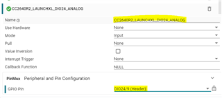

    And if I would like to mimic CC2640R2F to generate the same GPIO definitions in CC2640R2_LAUNCHXL.h, shall I manually add those weren't shown in ti_drivers_config.h through sysconfig?
    e.g. In CC2640R2_LAUNCHXL.h, I saw something like this:
    #define CC2640R2_LAUNCHXL_DIO24_ANALOG          IOID_24
    and I have't found it in my ti_drivers_config.h now, so I should add it through sysconfig like this:
    I'm not sure if I shall set the "GPIO Pin" to "DIO24/9 (Header)". Does DIO24 and 9 using the same PIN?
    Please correct me if I misunderstood anything.
    This is correct.
    This is also correct.
    When selecting "DIO24/9 (Header)", you actually select the DIO24 and the tools indicates it is mapped on the pin 9 of the LaunchPad. Please refer to the pinout of the LP-EM-CC2340R5 (https://www.ti.com/lit/swru588) for more details:

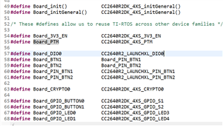

    I just wonder if there are C:\ti\simplelink_cc2640r2_sdk_3_40_00_10\source\ti\ble5stack\boards\CC2640R2DK_4XS\Board.h that defined things like this:
    #define Board_PTM               CC2640R2DK_4XS_PTM
    And in C:\ti\simplelink_cc2640r2_sdk_3_40_00_10\source\ti\ble5stack\boards\CC2640R2DK_4XS\CC2640R2DK_4XS.h it showed:
    #define CC2640R2DK_4XS_PTM                           IOID_6
    In the main code, it used "Board_PTM" rather than simply called CC2640R2DK_4XS_PTM (while Board.h and CC2640R2DK_4XS.h are under the same path).
    In my current understanding, in CC2340R5's syscfg we could do things like what CC2640R2DK_4XS.h did.
    Then, in CC2340R5's main code, shall we called CC2640R2DK_4XS_PTM  (assume that we have defined it in syscfg and it has been atomatically added in ti_drivers_config.h) directly or is there any way to do something like what Board.h did?
    Which way does TI recommended for CC2340R5?
    1. Calling items in ti_drivers_config.h directly
    or
    2. Further define items in Board.h and call items in it.
    (It seemed that for CC2640R2F, it used option 2, but in CC2340R5, Board.h has been removed. Does that mean I shall use option 1?)
    Thanks.
    This is correct understanding, on CC23xx devices SysConfig should be used to configure all the GPIO instances used.
    SysConfig will not produce the aliases (e.g. "Board_PTM") but you can produce them on your own if you need them.
    I'll let you assess if such aliases are useful in your case or if you prefer remove them.
    or
    TI recommends "Option 1".
