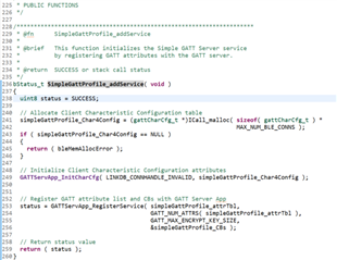

We are working on migrating an old project from CC2640R2F to CC2340R5.
I found a function called "DevInfo_AddService()" originated from PROFILES/devinfoservice.c.
I'm not sure if this file is originally generated by SDK or user-defined?
Plus, I also found some functions under PROFILES/simple_stream_profile_server.c, but still not sure where did this file come from?
Another one is C:\ti\simplelink_cc2640r2_sdk_3_40_00_10\kernel\tirtos\packages\ti\sysbios\knl\Task.h, I have some functions defined in it, but I didn't find "Task.h" in CC22340R5 sample codebase.
Furthermore, in Task.h, it would also called a header file "xdc/std.h", and std.h called "ti/targets/select.h".
But "ti/targets/select.h" could only be found in C:\ti\simplelink_cc2640r2_sdk_3_40_00_10\kernel\tirtos\packages\ti\targets\select.h. I didn't find any similar file under SimpleLink SDK 7.10.00.35 's path.
Please help us clarify how to use/find these functions in CC2340 codebase.

    Both functions (addService and simple_stream) are part of profiles and not part of the base. When you create a custom profile you add these functions. For example in the basic_ble profile the addservice function can be found inside common->profiles->  simple_gatt_profile.c.
    I wouldnt worry too much about finding the specific task.h file as the framework between the cc2340 and cc2640 have changed a bit. What did this file do for your project?
    Kind Regards,
    Rogelio

    A good reference to create a custom profile would be the cc26xx SLA
    https://dev.ti.com/tirex/content/simplelink_academy_cc13xx_cc26xxsdk_6_40_00_00/modules/ble5stack/ble_01_custom_profile/ble_01_custom_profile.html
    The workshop is still being created for the cc23xx but a lot of the information is the same. What I would focus on your migration would not be trying to migrate functions but instead try to recreate the functionality of your application with the new framework. May I ask what example is your project based on and what it acheives?

    For example, the function "DevInfo_AddService()" seemed to register a service via GATT.
    It was from PROFILES/devinfoservice.c, but in basic_ble sample project there's even no PROFILES/ folder.
    So I'm confused if I shall create the sample file like CC2640R2F did or has this function been moved to somewhere else?
    Thanks.

  • Hi YW,
    I agree adjusting to the new framework will take some work, but overall the new framework is to ease development of new projects.
    An example of adding a service is currently found in the Basic_ble example in the 7.10 SDK I would also look into the data_stream example as that example has a custom profile that transmits UART data over BLE very similar to the simple_serial_socket examples.
    Inside the app->profiles->app_dev_info.c
    Kind Regards,
