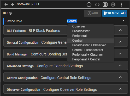

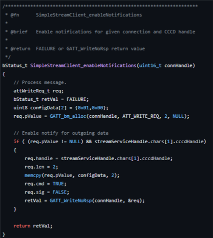

  • Hi Prince Singh,
    I'm glad to hear you have set up the peripheral side properly on the CC2340R5 and that it is working as expected!
    To set up the central side, you will need to set the BLE role as Central through SysConfig (shown below):
    Afterwards, when the project is built, all of the code that is necessary for the central project to operate will be uncommented and any that is not will be commented through the use if #ifdef statements.
    You will need to add logic for interacting with the characteristics themselves to the project, I would recommend adding this logic in the app_connection.c. You will need to reference some of the GATT functions present in the gatt.h file. You will need to call the GATT_RegisterForInd() to register to receive commands in the first place. You will also need to enable the notifications for the attribute itself. You can do this using GATT functions as well. An older example from the previous generation of devices has some sample code that may be a helpful reference (you may need to do some modifications as this is for an older SDK):
    This code may be found here: https://github.com/TexasInstruments/ble_examples/blob/simplelink_cc13x2_26x2_sdk-5.10/source/ti/ble5stack/profiles/simple_serial_stream/simple_stream_profile_client.c
    Jan

    Got it. As a quick test, can you try using GATT_DiscPrimaryServiceByUUID() and seeing if that returns a code or generates an event?
    Jan

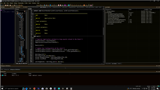

          While sending data from peripheral to central , my central device stuck in while(1) at
    void *Mtx_getTlsPtr(void)
    TaskHandle_t task;
    void *buf;
    if (xTaskGetSchedulerState() == taskSCHEDULER_NOT_STARTED)
    return (__section_begin("__iar_tls$$DATA"));
    /* running in a secondary thread */
    task = xTaskGetCurrentTaskHandle();
    buf = pvTaskGetThreadLocalStoragePointer(task, MTX_TLS_INDEX);
    if (buf == NULL)
    buf = __section_begin("__iar_tls$$DATA");
    vTaskSetThreadLocalStoragePointer(task, MTX_TLS_INDEX, buf);
    buf = pvPortMalloc(__iar_tls_size());
    if (buf != NULL)
    __iar_tls_init((char *)buf);
    else
    volatile int spin = 1;
    while (spin)
    return (buf);
    and it happens after recieving perticular number of bytes like 30 packets of 128 bytes data , and when i increase heap size in the sysconfig i can get more packets before going into this while  but again it goes into while loop, currently i am using heap size 4900 and when i decrese heap to 4500 i can get only 19 packets of data .

  • Hi Prince,
    Can you monitor the heap consumption during runtime while the behavior occurs? Do we see the heap increase slowly? We may be missing a free() call somewhere to deallocate previously allocated memory.
    Jan

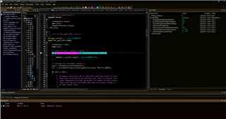

  • Hi Jan,
                i have debug the code into CCS also but same thing happenig after certain amount of data it goes into while(1) of void *Mtx_getTlsPtr(void). and you told that "We may be missing a free() call somewhere to deallocate previously allocated memory" is it about the example provided ? because i am not allocating any memory even i am not storing recieved data anywhere just sending the data from peripheral and then GATT_MSG_EVENT is generated and following line is called
    case GATT_MSG_EVENT:
    BLEAppUtil_processGATTEvents(pMsgData);
     after that void BLEAppUtil_processGATTEvents(BLEAppUtil_msgHdr_t *pMsg) is called
    Thank you

  • Hi Prince,
    Got it. Thank you for providing the code. The Debugging Common Heap Issues section of the User's Guide contains information on how to monitor heap. Can you check and see if we can see the heap increasing with each packet sent? If so, then can you verify how much?
    Jan

  • Hi Prince,
    My apologies for the delay. I took some time to research this issue further.
    Can you clarify exactly where you have placed the code you have provided? Based on your code, i think we are missing a GATT_bm_free() statement. I am basing this on how the SimpleSerialSocketClient handles received notifications. The relevant section is shown below:
    The code may be found here: https://github.com/TexasInstruments/ble_examples/blob/simplelink_cc13x2_26x2_sdk-5.10/examples/rtos/CC26X2R1_LAUNCHXL/ble5apps/simple_serial_socket_client/Application/simple_serial_socket_client.c
    The code is for a previous generation of device, but i expect the procedure to be very similar. i would start by trying to do GATT_bm_free() after you have extracted the data you need from the received pMsg.
    Jan
  • Hi Jan,
                 Now the heap issue is resolved using this free function ,
    Thank you
    Prince Singh
