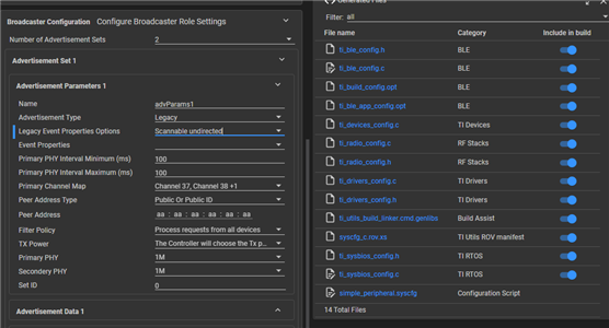

    What I want to know is when I am setting the "Legacy Event Properties Options = Connectable and Scannable" under advertising parameters of broadcaster configuration in .syscfg file of simple peripheral project, where is the piece of code which is dealing with it in simple peripheral project.

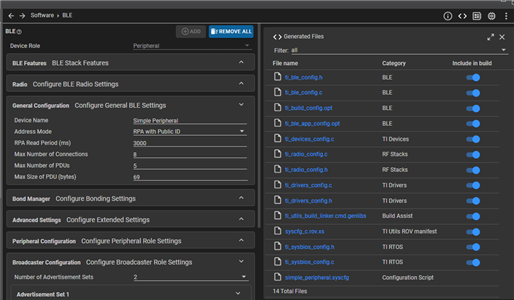

  • Hi Garvit,
    My sincerest apologies, I misunderstood your original question. Any changes made through SysConfig are identified in the Generated Files tab that may be opened by clicking on the following symbol:
    Afterwards, you will see the following:
    In the previous screenshot, you can see all of the files that are part of the SysConfig file generation. If any changes are made to the SysConfig while this window is opened, you will be able to see the exact difference the change made. For example, if we change the legacy event properties of the advertising parameter field for the first advertising set in simple_peripheral to Scannable Undirected (from Connectable Scannable undirected), we can see that the symbol next to the ti_ble_config.c, ti_sysbios_config.c and simple_peripheral.syscfg files changes. This denotes that these files were updated due to the change.

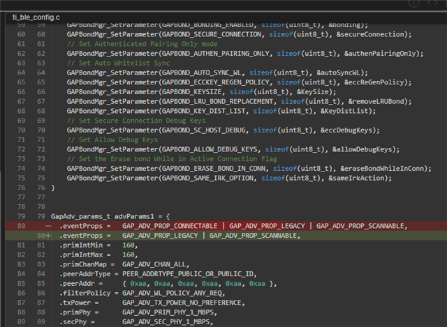

    If we click on the ti_ble_config.c file, then we will see the following:

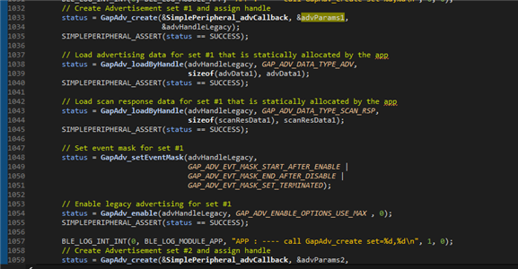

    We can see that the eventProps field of the advParams1 was changed and we can search for that variable in the simple_peripheral.c file. We can see that the variable is used during the creation and configuration of the advertising set in the next code snippet below:
    Specifically, the GapAdv_create() is the one that takes the advertising parameters and uses it to create the advertising set. It does all the necessary setup and processing in the background to ensure the advertising set is created properly and works as specified. To learn more about how the scanning and advertising parameters may be modified or changed, then I suggest referencing the Bluetooth LE Scanning and Advertising SLA.
