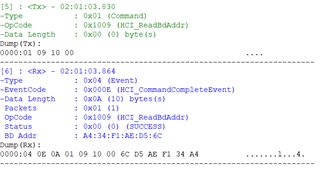

We used example project host_test to conduct some HCI commands for testing.
But during the test, we found that the RX of HCI_ReadBdAddr showed as follow:
The BD address was 00:00:00:00:00:00.
Our RF engineer thought this was weird since he had tested another CC2340R5 development kit (the two pieces looked identical) flashed with the same FW, and he didn't see "00:00:00:00:00:00" while testing with the same command.
How can we set this address and is this address related to MAC?
Thanks.

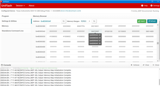

    On PG1.0, the value contained in 0x4E0003AF should be 0xFF, 0xFE or 0xFD.
    On PG2.0, the value contained in 0x4E0003AF should be 0x02, 0x03 or 0x04.
    You can easily read this value using Uniflash:
    I supposed we are using PG2.0.

    As I mentioned previously you have to select your board on Uniflash, check the memory section and  compare with the table above.

    TI: As I mentioned previously you have to select your board on Uniflash, check the memory section and  compare with the table above.
    --> Our 0x4E0003AF looked like 0x06?
    Is it PG1.0 or PG2.0?

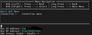

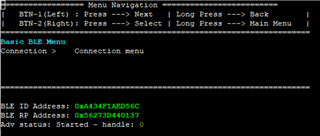

    TI: Otherwise, Is it possible to flash a basic_ble example on your device and check the UART serial port, you'll see normally both addresses your ID one (the one you suppose to get after the HCI_RdBdAddr()) and the RP one.
    --> Below is the result of our UART serial port:
    1. But I wonder what's the difference between ID address and RP address?

    Ok so your device BLE address is definitely 0xA434F1AED56C, it's the BD address or as also known as the ID address, this address is directly burned in the silicon, each chip has its own BD address, mandatory according to the Bluetooth specs.
    The RP address, is the address uses on the Bluetooth Low Energy protocol, it can be generated automatically or define in sysconfig, for more information about addresses please have a look at the user's guide in BLE5-Stack > Privacy section.
    If you reset the basic BLE example and keep the default settings you should be able to see the RP address changes for each reset. However, the ID address has still the same value.

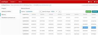

    Please instruct for item 2. Under this condition, how can we read its MAC address in UniFlash or even in command line(using dslite)?
    Thank you.
  • Hello all,
    You can find all this information in the CC2340 TRM. The bleAddress start at the address 0x4E000058 and it's 6 bytes long.
    regards,
    What we would also like to know is "how to  read its MAC address with UniFlash in command line(using dslite)"?
    Please answer this directly.
    Thanks.
    BR,
    Please refer to https://software-dl.ti.com/ccs/esd/uniflash/docs/v7_0/uniflash_quick_start_guide.html#memory-mode
    dslite can be used in memory mode to read a specific range of memory. Selecting the proper memory range (0x4E000058 to 0x4E00005E) you should get the MAC address exported to the file you want.
