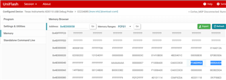

    To add on Isaac's answer, can you please dump the content of the BleAddr[] in the FCFG section?
    Here are some steps to do so:
    1) Open Uniflash and connect the debugger attached to the CC2340R5
    2) Read the content of address 0x4E000058.
    The image below shows the value we obtain:

    Here is the BleAddr[] in the FCFG section, looks to be all 0x0:
    Stuart
  • Hi Stuart,
    It definitely looks like you are using a PG1.0 device (i.e. pre-silicon device). On those devices, the Bluetooth LE address has not be written in the FCFG section.
    I recommend you order a new LP-EM-CC2340R5 (the LaunchPads we deliver now are based on PG2.0 silicon, i.e. production ready material).
