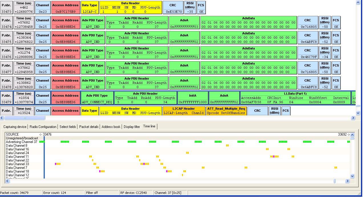

Hello TI Experts,
The image below is output of packet sniffer in my setup.
How can I reduce time duration of advertising? for example in the P.nbr. 33475 the advertising time duration is 138364us and I'm looking for a parameter which determine that. for your information I'm using keyfob project.
thanks.

    Our 1.0 release had a bug causing those "0's" you see in adv and scan response.  I would recommend upgrading to 1.1 release which you can find at ti.com/blestack.  The keyFob project has also been updated in 1.1 to send items below, but if power is major concern you can also reduce this.

  • The reason the advertising duration that you see is long is because you are transmitting additional zeros in your advertising data with each packet. By switching to v1.1 as Greg suggests, you will not transmit these additional zeros, which will effectively reduce the duration of the packets.
  • Hi Willis,
    Thanks for your advice. As you can see in the image bellow, I've  reduce the number 0s by changing advertising packet size, but I can't achieve to less than 100ms. it seems to be time interval between Advertising  event. Is this BLE stack limitation or I can use a parameter to reduce 100ms and for example achieve to 80ms?
    Thanks.
  • Use GAP_SetParamValue, and change the value of the parameters TGAP_CONN_ADV_INT_MIN  and TGAP_CONN_ADV_INT_MAX.
