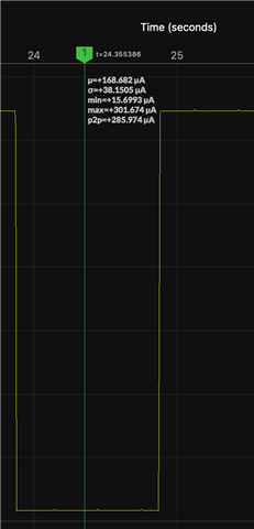

using the gpiostandby example, my standby current seems much higher than it should be -- approximately 168uA....  here is the signal i'm seeing:
i'm powering my board externally, and i have removed the 10-pin debug cable....  i've left the jumper in-place for the LED, hence the additional ~6mA of current every other second....
the generated ti_drivers_config.c file does contain a call to Board_shutdownExtFlash() as expected; but what else on my launchpad could be drawing this much current when my program is suspended????  other than GPIO, i'm not using any other drivers....
my expectations were for current in the ~1uA range....

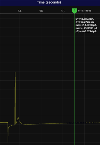

    i'm now down to ~40uA -- better, but still 10x higher than i would have expected
    was your measurement actually ~3-4 uA????

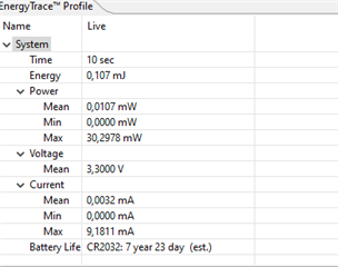

    If so, do you have the possibility to access any other energy measurement tool as Energy trace is not very suitable for this low currents with an accuracy of +-700 nA this will not have a very good accuracy here. However it should be enough to show that the current is not 150µA
    I repeated the measurement with energy trace and can confirm that I do not see the 150µA with the GPIO example.

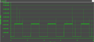

    Toggeling the red Led with a Frequency of 1 Hz:
    I see the following results using EnergyTrace:
    With set Jumper

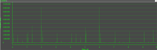

    After Removing the Jumper it looks like this:
