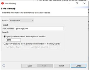

    In the memory browser I have done the following setting -
    and I am getting following error -
    Garvit
  • Hi Garvit,
    I checked, and it seems the buffer is still named "gBleLogBuffer". There might be something else not correct there.
    Can you confirm you have added the BLE_LOG predefined symbol to your project? It means you should right click on the project > Properties > Build > Arm Compiler > Predefined Symbols then add a new symbol.
    I added following code to simple_central.c -
    If I may, I don't think this is required.
    I hope this will help,
