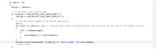

    To get advertising device name, i changed memcpy(pAddrTemp, Util_convertBdAddr2Str(advRpt.addr),SC_ADDR_STR_SIZE); to memcpy(pAddrTemp, Util_convertBdAddr2Str(advRpt.pData),SC_ADDR_STR_SIZE);.
    But in terminal it's printing the default hex values. When trying to connect at that time MAC ID is printing.
    Please refer the attached snippets from our observations.

    As per previous reply, changed the DevieName as peerDeviceName(defined globally) then sysconfig also i added Address/Address type/Data length.
    After changing the buffer name, data is not updated.
    we checked in debug mode , in SimpleCentral_findDeviceName function i am getting adType & dataLen as random values such as 8192,255,80,0 and so on.
    But there is a condition for short name and full name attached in below snippets
    Because of this , it's not entering into this if loop. This what we observed in debug mode.
    Please kindly share your inputs.
    Thanks & Regards,
    Abinesh R
  • Hi Abinesh,
    Can you confirm the stack has been configured (through SysConfig) to report the data length? (see my previous message)
    Also, are you sure you are executing the SimpleCentral_findDeviceName() before the pData buffer is freed? (see my previous message)

    static void SimpleCentral_init(void)
      uint8_t i;
      BLE_LOG_INT_TIME(0, BLE_LOG_MODULE_APP, "APP : ---- init ", SC_TASK_PRIORITY);
      // Create the menu
      SimpleCentral_buildMenu();
      // N0 STACK API CALLS CAN OCCUR BEFORE THIS CALL TO ICall_registerApp
      // Register the current thread as an ICall dispatcher application
      // so that the application can send and receive messages.
      ICall_registerApp(&selfEntity, &syncEvent);
      // Create an RTOS queue for message from profile to be sent to app.
      appMsgQueue = Util_constructQueue(&appMsg);
      // Initialize internal data
      for (i = 0; i < MAX_NUM_BLE_CONNS; i++)
        connList[i].connHandle = LINKDB_CONNHANDLE_INVALID;
        connList[i].pRssiClock = NULL;
      Board_initKeys(SimpleCentral_keyChangeHandler);
      GGS_SetParameter(GGS_DEVICE_NAME_ATT, GAP_DEVICE_NAME_LEN,
                       (void *)attDeviceName);
      //Set default values for Data Length Extension
      //Extended Data Length Feature is already enabled by default
      //in build_config.opt in stack project.
        //Change initial values of RX/TX PDU and Time, RX is set to max. by default(251 octets, 2120us)
        #define APP_SUGGESTED_RX_PDU_SIZE 251     //default is 251 octets(RX)
        #define APP_SUGGESTED_RX_TIME     17000   //default is 17000us(RX)
        #define APP_SUGGESTED_TX_PDU_SIZE 27      //default is 27 octets(TX)
        #define APP_SUGGESTED_TX_TIME     328     //default is 328us(TX)
        //This API is documented in hci.h
        //See the LE Data Length Extension section in the BLE5-Stack User's Guide for information on using this command:
        //http://software-dl.ti.com/lprf/ble5stack-latest/
        HCI_EXT_SetMaxDataLenCmd(APP_SUGGESTED_TX_PDU_SIZE, APP_SUGGESTED_TX_TIME, APP_SUGGESTED_RX_PDU_SIZE, APP_SUGGESTED_RX_TIME);
      // Initialize GATT Client
      VOID GATT_InitClient("");
      // Register to receive incoming ATT Indications/Notifications
      GATT_RegisterForInd(selfEntity);
      // Initialize GATT attributes
      GGS_AddService(GATT_ALL_SERVICES);         // GAP
      GATTServApp_AddService(GATT_ALL_SERVICES); // GATT attributes
      // Register for GATT local events and ATT Responses pending for transmission
      GATT_RegisterForMsgs(selfEntity);
      // Set Bond Manager parameters
      setBondManagerParameters();
      // Start Bond Manager and register callback
      // This must be done before initialing the GAP layer
      VOID GAPBondMgr_Register(&bondMgrCBs);
      // Accept all parameter update requests
      GAP_SetParamValue(GAP_PARAM_LINK_UPDATE_DECISION, GAP_UPDATE_REQ_ACCEPT_ALL);
      // Register with GAP for HCI/Host messages (for RSSI)
      GAP_RegisterForMsgs(selfEntity);
      BLE_LOG_INT_TIME(0, BLE_LOG_MODULE_APP, "APP : ---- call GAP_DeviceInit", GAP_PROFILE_CENTRAL);
      // Initialize GAP layer for Central role and register to receive GAP events
      GAP_DeviceInit(GAP_PROFILE_CENTRAL, selfEntity, addrMode, &pRandomAddress);
      dispHandle = Display_open(Display_Type_ANY, NULL);
      // Disable all items in the main menu
      tbm_setItemStatus(&scMenuMain, SC_ITEM_NONE, SC_ITEM_ALL);
      // Initialize Two-button Menu
      tbm_initTwoBtnMenu(dispHandle, &scMenuMain, 5, SimpleCentral_menuSwitchCb);
      Display_printf(dispHandle, SC_ROW_SEPARATOR, 0, "====================");
     * @fn      SimpleCentral_taskFxn
     * @brief   Application task entry point for the Simple Central.
     * @param   none
     * @return  events not processed
    static void SimpleCentral_taskFxn(uintptr_t a0, uintptr_t a1)
      // Initialize application
      SimpleCentral_init();

        case SC_EVT_ADV_REPORT:
          //Auto connect is enabled
          if (autoConnect)
            if (numGroupMembers == MAX_NUM_BLE_CONNS)
              GapScan_disable("");
              break;
            //Check if advertiser is part of the group
            if (SimpleCentral_isMember(pAdvRpt->pData , acGroup, GROUP_NAME_LENGTH))
         	  groupListElem_t *tempMember;
         	  //Traverse list to search if advertiser already in list.
      	      for (tempMember = (groupListElem_t *)osal_list_head(&groupList); tempMember != NULL; tempMember = (groupListElem_t *)osal_list_next((osal_list_elem *)tempMember))
                if (osal_memcmp((uint8_t *)tempMember->addr ,(uint8_t *)pAdvRpt->addr,B_ADDR_LEN))
                  break;
              //If tempMemer is NULL this means advertiser not in list.
              if (tempMember == NULL)
                groupListElem_t *groupMember = (groupListElem_t *)ICall_malloc(sizeof(groupListElem_t));
                if (groupMember != NULL)
                  //Copy member's details into Member's list.
                  osal_memcpy((uint8_t *)groupMember->addr , (uint8_t *)pAdvRpt->addr,B_ADDR_LEN);
                  groupMember->addrType = pAdvRpt->addrType;
                  groupMember->status = GROUP_MEMBER_INITIALIZED;
                  groupMember->connHandle = GROUP_INITIALIZED_CONNECTION_HANDLE;
                  //Add group member into list.
                  osal_list_putHead(&groupList,(osal_list_elem *)groupMember);
    			  numGroupMembers++;
    		      count=1;
                else
                  Display_printf(dispHandle, SC_ROW_AC, 0, "AutoConnect: Allocation failed!");
                  break;
    #if (DEFAULT_DEV_DISC_BY_SVC_UUID == TRUE)
          if (SimpleCentral_findSvcUuid(SIMPLEPROFILE_SERV_UUID,
                                        pAdvRpt->pData, pAdvRpt->dataLen))
            SimpleCentral_addScanInfo(pAdvRpt->addr, pAdvRpt->addrType);
            Display_printf(dispHandle, SC_ROW_NON_CONN, 0, "Discovered: %s",
                           Util_convertBdAddr2Str(pAdvRpt->addr));
    #else // !DEFAULT_DEV_DISC_BY_SVC_UUID
          SimpleCentral_findDeviceName(pAdvRpt->pData, pAdvRpt->dataLen, peerDeviceName, MAX_SIZE);
    #endif // DEFAULT_DEV_DISC_BY_SVC_UUID
          //SimpleCentral_findDeviceName(pAdvRpt->pData, advRpt.dataLen, peerDeviceName, MAX_SIZE);
          // Free report payload data
          if (pAdvRpt->pData != NULL)
            //SimpleCentral_findDeviceName(pAdvRpt->pData, pAdvRpt->dataLen, peerDeviceName, MAX_SIZE);
            ICall_free(pAdvRpt->pData);
          break;

    static bool SimpleCentral_findDeviceName(uint8_t *pData, uint16_t dataLen, char *deviceName, uint8_t maxNameLength)
        uint8_t adLen;
        uint8_t adType;
        uint8_t *pEnd;
        // Erase the content of deviceName
            int i;
            for (i=0; i<maxNameLength ; i++)
                deviceName[i] = '\0';
        // Parse the advertisement data
        if (dataLen > 0)
            pEnd = pData + dataLen - 1;
            // While end of data not reached
            while (pData < pEnd)
              // Get length of next AD item
              adLen = *pData++;
              if (adLen > 0)
                adType = *pData++;
                // If AD type is for device name
                if ((adType == GAP_ADTYPE_LOCAL_NAME_SHORT) ||
                    (adType == GAP_ADTYPE_LOCAL_NAME_COMPLETE ))
                    // For the whole length of the device name found
                    int i;
                    for (i=0; i<= adLen-1; i++) // looping until (adLen-1) because adLen also accounts for the size of the adType (1 byte)
                        if(i < maxNameLength)
                            deviceName[i] = (char)*pData++;
                    return TRUE;
                else
                  // Go to next item
                  pData += adLen;
    thanks and regards
    Abinesh.R
    I see the values of ScanData  and ScanData_Len are still updated after "case SC_EVT_SCAN_ENABLED". It might worth moving this code inside "case SC_EVT_ADV_REPORT" to help debugging.
    The second element I see, you are running passive scanning, it means only the content of the advertising data will be received (no scan response). By default the long name of the advertiser is contained in the scan response.
    It can be done by changing:
          // Set Scan PHY parameters
          GapScan_setPhyParams(DEFAULT_SCAN_PHY, SCAN_TYPE_PASSIVE,
                               DEFAULT_SCAN_INTERVAL, DEFAULT_SCAN_WINDOW);
    In:
          GapScan_setPhyParams(DEFAULT_SCAN_PHY, SCAN_TYPE_ACTIVE,
