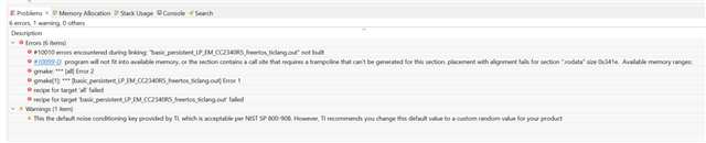

ISSUE: basic_persistent application giving compilation error out of the box, its giving the following error:
 Description Resource Path Location Type
<a href="file:/C:/ti/ccs1220/ccs/tools/compiler/dmed/HTML/10099.html">#10099-D</a> program will not fit into available memory, or the section contains a call site that requires a trampoline that can't be generated for this section. placement with alignment fails for section ".rodata" size 0x341e. Available memory ranges: cc23x0_app_freertos.cmd /basic_persistent_LP_EM_CC2340R5_freertos_ticlang line 240 C/C++ Problem
Please let me know what should be done or if I am doing something wrong.

  • Hi Harinder,
    The 7.20 SDK version of the SimpleLink Low Power F3 SDK has been released on ti.com recently. You may download this version here: https://www.ti.com/tool/download/SIMPLELINK-LOWPOWER-F3-SDK
    This releases includes several improvements and fixes which may solve the issue you are facing. Can you download this version and test? Please ensure you are using the recommended CCS version (12.4) during your testing.

  • Dear Sir,
    Thanks for your quick response!
    hurrah!!  :)  The OAD example is working with 7.20 SDK version of the SimpleLink Low Power F3 SDK & I have used recommended CCS version (12.4) for the testing.

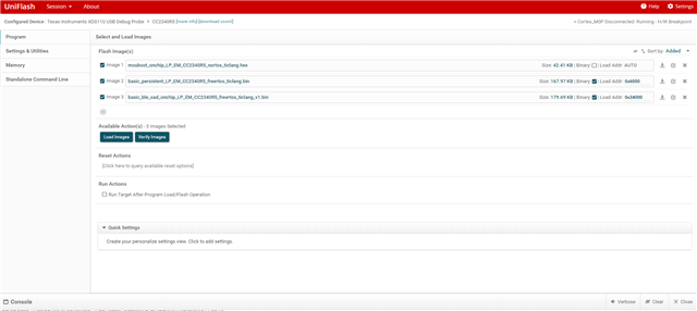

    The issue I have observed is after loading the initial files (mcuboot, persistent app & basic_ble) through uniflash the CC2340R4 don't launch the basic_ble app instead it launch the persistent app, it apperars like the basic BLE app is not loaded to correct address or not detected by the persistent app after intial boot up process. The basic_BLE app runs only after doing the initial OAD process through BTool. After loading the basic_BLE through BTool over the OAD it works well after bootups.

    In response to: "Are the addresses in the UniFlash image the default values or are these custom values?"
    I have refed the address from other threads on the e2e form, don't know if they are correct. please confirm me back the addresses that we will need to set in the target device for MCU boot, Persistant & basic ble apps.
    Harinder Singh

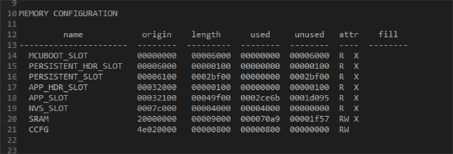

  • Hi Harinder,
    Can you try using the addresses that are found in the .map file (present inside the Release/Debug folder after you build your projects). An example is found below:

  • Dear Sir,
    Thanks for confirmation, it's working now smoothly... :)
    Issue was in the addressing of the Basic_BLE app. Need to set it's base address to 0x32000.
