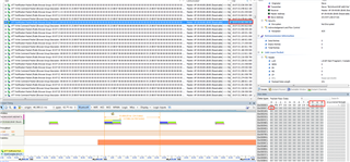

The time points 19.07.33.081 and 19.07.33.096 are the same, starting with 00 87 C3 B4

    I do see a duplication of the payload starting with 00 87 C3 B4 00... in the log.
    It is interesting to notice that, when comparing the two packets, even if the ATT payloads are identical, the LL headers and CRCs are different.
    It means the packet duplication comes from the host layer or from the application layer (on the module side).
    A second interesting piece of information to notice is the packet duplication for the payloads 00 87 D2  XX 00, 00 87 E6  XX 00, 00 87 FA  XX 00, 00 87 FA  XX 00, 00 88 0F XX 00. For all these packets only the 4th byte changes (which does not seem to be the most frequent in the rest of the packets). Any idea why we observe this? Could it help us identifying a path forward?
