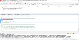

I'm working on BLE central. My requirement involves enabling a GPIO callback and executing a function in response to the gpio interrupt. Inside the callback function, I am invoking a handling function "BLEAppUtil_invokeFunction(HandlingFunction2, pData);"  to send some data to the peripheral. But as soon as I give the gpio interrupt, the system is going to hang state. Hang state as in, it is not responding, it needs a power restart to function again properly.
Note: I have confirmed the system is acting strange when I am giving BLEAppUtil_invokeFunction(HandlingFunction2, pData); fxn. and HandlingFunction2 fxn is nothing but a uart message.
Help me to resolve this issue ASAP. I'm using the latest SDK, "simplelink_lowpower_f3_sdk_7_10_00_35", basic_ble code in Central mode.

    void BUTTON_ENBLE(keysPressedCB_t appKeyCB){
        GPIO_init();
        GPIO_setCallback(START_BUTTON, StartButtonfxn);
        /* Enable interrupts */
        GPIO_enableInt(START_BUTTON);
    void StartButtonfxn(uint_least8_t index)
        keysPressed = 0;
        char *pData;
        if (GPIO_read(START_BUTTON) == 0 )
            keysPressed |= KEY_START_PRESS;
            startPressed = 1;
            if (!functionCalled)
                char leadMePacket[4] = { 0x24, 0xAC, 0x04, 0x24 };
                pData = &leadMePacket[0];
                functionCalled = 1; // Set the flag to indicate the function has been called
                UART2_write(uart, "Button_start",12,0);

  • Hi Jan
    Invoking in Uart call back is working fine for me. I am clear about that part. But the GPIO interrupt is where I am facing this issue.
    Can you share which file you are calling this in?
    I have a separate file in the application for GPIO interrupt which I am calling void BUTTON_ENBLE(keysPressedCB_t appKeyCB) fxn.
    Has the BLEAppUtil task/framework been set up already?
    I am confused what framework you meant, if it is this file #include <ti/bleapp/ble_app_util/inc/bleapputil_api.h> , yes I am adding it to my file.

    I have implemented using the BLEAppUtil_invokeFunctionNoData() inside a GPIO interrupt successfully. I have modified the data_stream example to perform different characteristics write based on the GPIO interrupt that occurs. All code modifications were made in app_data_stream.c (with some SysConfig changes). The content of the app_data_stream.c file is shown below:
