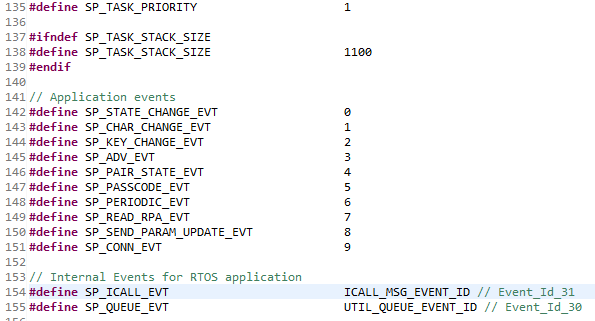

  • I found out the problem because of stack overflow . how can i select true size of stack . after increase it to 1300 . bluetooth side dont work

    When you changed the stack size did you change "#define SP_TASK_STACK_SIZE" in simple_peripheral.c? I increased the value from 644 to 1300, and was able to connect to the device using my Android S21 FE phone (using BLE Scanner, default example). It seems like your detectLongPeaks is custom code you have added to the project, did you step through the function and confirm what line causes the crash?

  • Hello alex , after increase stack  to 1100 code work very well but bluethooth no start  and when increase to 1200 code dont start . and when set to 960 bluethooth start but adc read one time . i have 4 event did i problem in event id ???
    #ifndef SBP_TASK_STACK_SIZE
    #define SBP_TASK_STACK_SIZE                   1100
    #endif
    // Application events
    #define SBP_STATE_CHANGE_EVT                  0x0001
    #define SBP_CHAR_CHANGE_EVT                   0x0002
    #define SBP_PAIRING_STATE_EVT                 0x0004
    #define SBP_PASSCODE_NEEDED_EVT               0x0008
    #define SBP_CONN_EVT                          0x0010
    // Internal Events for RTOS application
    #define SBP_ICALL_EVT                         ICALL_MSG_EVENT_ID // Event_Id_31
    #define SBP_QUEUE_EVT                         UTIL_QUEUE_EVENT_ID // Event_Id_30
    #define SBP_PERIODIC_EVT                      Event_Id_29
    #define LED_CONTROL_EVT                       Event_Id_28
    #define BLE_CONTROL_EVT                       Event_Id_27
    #define BUTTON_CONTROL_EVT                    Event_Id_26
    #define SENSOR_CONTROL_EVT                    Event_Id_25
    // Bitwise OR of all events to pend on
    #define SBP_ALL_EVENTS                        (SBP_ICALL_EVT        | \
                                                   SBP_QUEUE_EVT        | \
                                                   SBP_PERIODIC_EVT     | \
    											   LED_CONTROL_EVT      | \
    											   BLE_CONTROL_EVT      | \
    											   BUTTON_CONTROL_EVT   | \
    											   SENSOR_CONTROL_EVT)

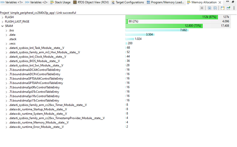

  • I found  the problem . my sdram usage  is full because of 250 sample of adc . now i am try to reduce my usage of sdram .
