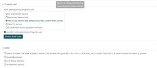

    3. If you can flash the device correctly, do you get any warning messages at the console (yellow color) or just the SUCCESS one (green color)?
    4. Have you modified anything on the Settings & Utilities section? (Program Load or CCFG options for example?)
    David.
  • Hey David,
    1. Yeah I was using the correct load address.
    2. Yeah I was able to flash the files without any errors.
    3. I get a [SUCCESS] Program Load completed successfully.
    4.
    Thanks again,
    Kenneth
