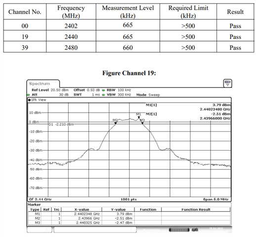

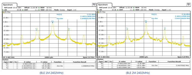

1. We would like to use smartRF to send continuois TX and expect to see a non-single tone waveform as the output.
But what we got was like below:
How can we configure smartRF to get something like this?

    For point 1 -
    If I understand correctly the setting you want is to enable a modulated tone. This can be done in SmartRF Studio 8 with the "TX signal type" dialogue:
