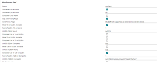

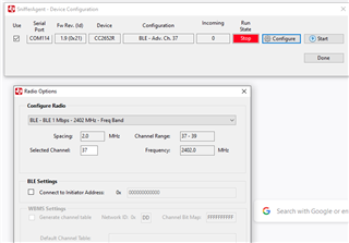

I am currently using the simple peripheral example SDK 7.10.01.24 but I having problems advertising a service UUID during advertisement. The goal is for a mobile device to scan and filter based on advertised Service UUID. I have modified settings in sysconfig of the parameter in the advertisement set 1 & 2 with no success. How do I broadcast a service UUID during advertisement
