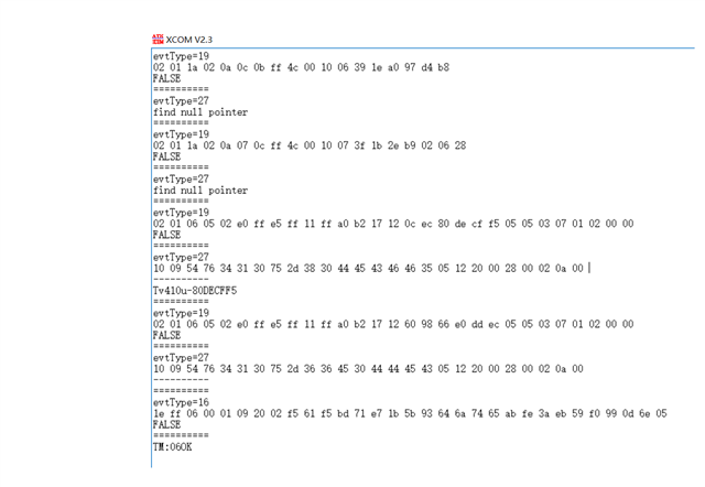

Regarding the migration of the host program from the CC2642 Bluetooth module to the CC2340,
when the gap_ADTYPE_local_name_complete is obtained,
sometimes the advertisement data is received and sometimes the advertisement response data is received.
Both cannot be received at the same time, causing the Bluetooth name of the slave to not be correctly obtained, as shown in the figure.

  • Hi David,
    1.SDK: simplelink_lowpower_f3_sdk_7_20_00_29
    2.Yes,basic_ble for instance.
    3.The location where I read the pAdvReport is void Central_ScanEventHandler(uint32 event, BLEAppUtil_msgHDr_t *pMsgData) -> case BLEAPPUTIL_ADV_report:
    to see the code attached below me.

    4.Yes, the peripheral I use has full local names in both the scan response and the advertisement data.

  • Hi David,
    But when I use the CC2642, I get the broadcast name normally.
    This is the data that I scanned using the CC2642, which contains the complete advertisement data and scan response data, and scanning other BLE modules can get the full data as well, but the data obtained on the CC2340 is not complete.
    You can see in the data, the above data is advertisement data and scan response data, below is the corresponding advertisement name, my specific device is Tv410u-699E7FF8 on this CC2642 you can see the complete packet.

  • Hi David,
    1. The example simple_central is used on CC2642, and the SDK version is simplelink_cc13xx_cc26xx_sdk_7_10_01_24.
    2. No project modifications were made, just trying to read the Bluetooth name in app_central.c -> Central_ScanEventHandler ->case BLEAPPUTIL_ADV_REPORT:
    and printing MenuModule_printf(APP_MENU_SCAN_EVENT + indx, 0, "Data: %d", pScanRpt->pData[indx ]);,
    it is found that the broadcast data and response data are separated, unlike CC2642 which is a complete package.
    3. Yes, the CC2340 host is configured for active scanning

  • Hi David,
    The scanning report of CC2642 is printed in the same place as CC2340.
    static void SimpleCentral_processAppMsg(scEvt_t *pMsg) ->case SC_EVT_ADV_REPORT:
    -> GapScan_Evt_AdvRpt_t* pAdvRpt = (GapScan_Evt_AdvRpt_t*) (pMsg->pData);
            Get_Adtype_Data( GAP_ADTYPE_LOCAL_NAME_COMPLETE,
                                          pAdvRpt->pData,
                                          pAdvRpt->dataLen,
                                         &adTypeData_index,
                                         &adTypeData_len);

    1. Through the printed report, I found that the broadcast data and scan response are separated.
    The current processing is to skip the broadcast data and directly receive the scan response data to obtain the local name.
    I just don’t understand why the broadcast data and scan response scanned on CC2642 are together, but the data scanned on CC2340 are separate.
