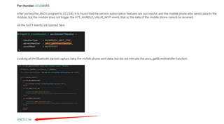

After porting the ANCS program to CC2340, it is found that the service subscription features are successful, and the mobile phone also sends data to the module, but the module does not trigger the ATT_HANDLE_VALUE_NOTI event, that is, the data of the mobile phone cannot be received.
All the GATT events are opened here.
Looking at the Bluetooth packet capture data, the mobile phone sent data, but did not execute the ancs_gattEventHandler function.
ANCS-2.rar

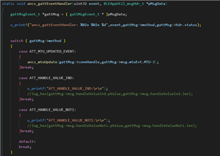

    static void ancs_gattEventHandler(uint32 event, BLEAppUtil_msgHdr_t *pMsgData)
        gattMsgEvent_t *gattMsg = ( gattMsgEvent_t * )pMsgData;
        u_printf("ancs_gattEventHandler: %02x %02x %d",event,gattMsg->method,gattMsg->hdr.status);
        switch ( gattMsg->method )
            case ATT_MTU_UPDATED_EVENT:
                ancs_mtuUpdate(gattMsg->connHandle,gattMsg->msg.mtuEvt.MTU-3);
            }break;
            case ATT_HANDLE_VALUE_IND:
                u_printf("ATT_HANDLE_VALUE_IND:\r\n");
                //log_hex(gattMsg->msg.handleValueInd.pValue,gattMsg->msg.handleValueInd.len);
            }break;
            case ATT_HANDLE_VALUE_NOTI:
                u_printf("ATT_HANDLE_VALUE_NOTI:\r\n");
                //log_hex(gattMsg->msg.handleValueNoti.pValue,gattMsg->msg.handleValueNoti.len);
            }break;
            default:
            break;

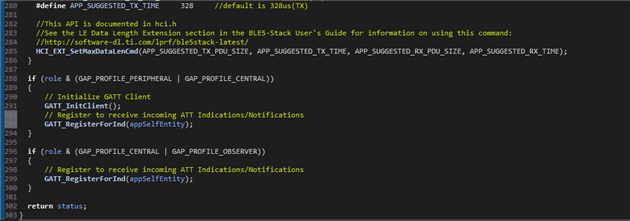

    Are you receiving any other event? In other words, is the default case in line 129 ever being executed? As a quick test, instead of masking for all events could you try just masking for the events that are of interest?  For example, instead of doing 0xFFFFFFFF, could you do BLEAPPUTIL_ATT_MTU_UPDATED_EVENT | BLEAPPUTIL_ATT_HANDLE_VALUE_NOTI | BLEAPPUTIL_ATT_HANDLE_VALUE_NOTI?
    Taking a bit of a step back, are you attempting to send a notification to the phone or receive one from the phone?
    Jan
  • Hi.
    ANCS function is that CC2340 does peripheral mode, after the Apple cell phone is connected, CC2340 carries out the discovery of ANCS service, subscription. However, when the phone has information, the phone sends notificationdata to the CC2340,CC2340 did not execute ATT_ HANDLE_ Value_ NOTI Event
    Looking at the LOG print, when the phone sends data to the CC2340, it does not call the ancs_gattEventHandler function, i.e., it does not execute the default
    I am able to receive ATT_MTU_UPDATED_EVENT, ATT_FIND_BY_TYPE_VALUE_RSP, ATT_READ_BY_TYPE_RSP, ATT_FIND_INFO_RSP, ATT_WRITE_RSP, and ATT_ERROR_RSP events, I am just not able to receive ATT_HANDLE_VALUE_NOTI
    For another project, I have tested the CC2340 in central mode with eventMask configured to 0xFFFFFFFF and it is possible to execute the ATT_HANDLE_VALUE_NOTI event when data is received from the slave.I suspect that perhaps the protocol stack ATT_HANDLE_VALUE_NOTI events are not reported to the application layer when the CC2340 is configured in peripheral mode
    Got it. Thank you for the additional information. Do you have access to a bluetooth sniffer? If so, then could you take a log of the CC2340R5 advertising, connecting, and then the iOS device sending the notifications? I would like to see what is happening over the air and confirm that the expected data is being sent.

    At a glance, it looks okay. Can you confirm what the call for ancs_writeData() returns when done as part of the notification enabling procedure? I want to ensure we are not getting a bleInvalidRange or bleNoresources error.
    Best Regard,
    Jan
  • Hi.
    ancs_cfigNotifSrc and ancs_cfigDataSrc both return a value of 0
    Got it. Returning code 0 indicates that the functions all returned SUCCESS which is good. I would like to see if the bleapputil framework is catching the event, but failing to pass it up to the application.

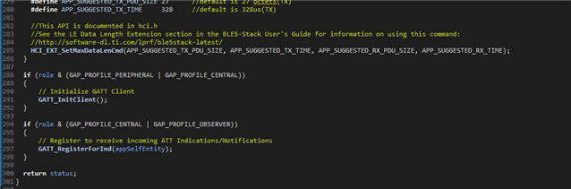

    Can you take a look at the BLEAppUtil_processGATTEvents inside the bleapputil_process.c linked resource located within the common/BLEAppUtil folder in your project? I would recommend replacing the bleapputil_process.c linked resource with a local copy. You can do this by right clicking on bleapputil_process.c and clicking on Show in local terminal -> system explorer. Then delete the local linked reference in your project and then click and drag the local file located in the file explorer that opened when you clicked on system explorer and drop it in the BLEAppUtil folder in your project. When prompted with a window, ensure you select the copy option to create a local copy of the file.
    This will allow you to modify the file freely without modifying the SDK copy of the file which will impact other projects.

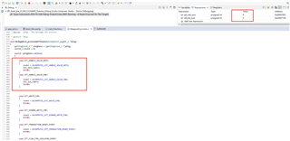

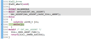

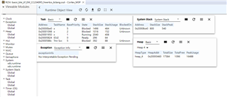

    At this point, lets add a case ATT_HANDLE_VALUE_NOTI and inside lets add a global variable that is increment every time the case is triggered. Lets run a test where we monitor the global variable while in debug mode to determine if the case is ever entered.
    Jan
  • Hi.
    According to your method, after the phone sends notify data to the module, the program does not execute to BLEAppUtil_processGATTEvents
    Got it. Thank you for running the test! I think we may need to take a bit of a step back and see if this issue is due to the ANCS implementation itself or something more closely linked to how the BLEAppUtil Framework handles incoming notifications when in peripheral mode. Can you share the extent of the modifications made to the example and can you clarify if you are working off the datastream or ble basic example?
    Jan
  • Hi.
    The project uses the "basic_ble" example and only adds ancs_start at the end of the App_StackInitDoneHandler, nothing else is changed.

    Got it. Thank you! I think there may be an issue here with how the event is being handled by the bleapputil. I will file a ticket for this. Could you provide the iOS version you are using for your testing?
    Jan

    The ANCS service is on the phone, and I can't pass in the gattAttribute_t parameter when calling the GATTServApp_ProcessCCCWriteReq interface.
    I've successfully implemented the ANCS function on the CC2640, but the CC2340 doesn't work with the same approach
    I'll upload the code, can you verify directly on it

    Looking through the code, I don't believe we are registering for indications/notifications on the BLE stack itself. This is done by calling GATT_RegisterForInd(). This is done when the device is in central mode automatically within the ble_stack_api.c file located inside the common/iCallBLE directory contained within the basic_ble project. This file is a referenced resource so lets replace it with a local copy before we make any modifications (using the instructions provided previously. The original file has the following relevant code within the bleStack_initGATT() file:
    Can you try changing it such that the case for the observer also registers for notifications as follows?
    Ensure this is done in a local copy to not impact other projects in your SDK. Can you test if this works on your side? I do not have an iOS with me at this time. I will try to source one tomorrow to assist with testing.
    Jan
  • Hi.
    Thanks, after calling this interface GATT_RegisterForInd, I can receive data from the phone. But when I send data to the cell phone, sometimes calling the GATT_WriteCharValue interface will not quit,Usually occurs when the phone is disconnected, after reconnection
    basic_ble_LP_EM_CC2340R5_freertos_ticlang_2.rar
    Im glad to hear we were able to resolve the notification not being received issue! Can you clarify what you mean by the function wont quit? DO you mean it never returns or returns failure? Does the code hang? If it does hang, then can you try pausing the execution and sharing a picture of the call stack? If the program does not get stuck, but simply not perform the write, then can you share the return code of GATT_WriteCharValue()? If it does get stuck, then can you record the return codes leading up to the code hanging?

  • The program does not return after calling GATT_WriteCharValue, the program executes to ICall_abort.
    This is the serial port log, the code was uploaded in the last reply

    Got it. Thank you for the update. I think we should observe if the heap or stack is overflowing.
    Can you reference the Debugging Common Heap Issues section of the debugging guide and verify what what the status of the heap is in the events leading up to the behavior and once the device hands?
    The ICall Abort section also provides some more information on why the abort may be occurring.
