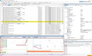

    I use the Honor Magic 5 pro( Cell phone ) to connect and disconnect CC2642, after multiple disconnections and connections, there is a probability of the need for pairing again. I'm sure that the CC2642 NVS is normally, the NVS data(adr: 0x50000~0x54000) which includes the bonding information is persistent.
   For the BLE project, the CC2642 is used as multi role, and our application directly uses GAPBondMgr, so for the app level, I think I just config the BondMgr in the entry init. The BondMgr Config Information is set as below:
  And by the way, the Link layer local supported feature value I set is
    uint64_t u64Features = 0x000000000000000FB;
    HCI_EXT_SetLocalSupportedFeaturesCmd((uint8 *)&u64Features);
  Will this issue be related to the local supported feature?
