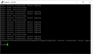

    1. I try to test the simple_serial_socket_client_app_CC26X2R1_LAUNCHXL_tirtos_ccs and the simple_serial_socket_server_app_CC26X2R1_LAUNCHXL_tirtos_ccs and download them into 2 separate LP_CC2652RB EVM board, but these to boards didn't get connected. No led indicator and nothing happens in the PUTTY. Do you have suggestion for that?

    Now i can change the IC by delete the BLE in the sysconfig and add a new one. i can make these 2 CC2652RB board connected and transfer data.
    the problem  now is that it sometime will disconnected with each other, only red LED on and then automatic connected.
    also it is so low to get  the from server when typing and  , . sometimes it just stops to transmit and disconnected
    is the reason  from the BLE setting? can you guide me how to make a stable connection here?

    I am very glad to hear you were able to get the issue resolved! If the data transmission is very slow, then you could try decreasing the connection interval to make the updates more frequent. With regards to connection stability, there's a few things that can be done listed below:
    1. Increase txPower
    2. Ensure boards are close to each other
    3. Modify connection parameters (Peripheral Latency and Supervision timeout)
