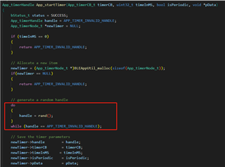

The CC2340 uses fmnap's project to create a timer with App_startTimer, and when I look at this interface code, the handle is generated by a random number. When I create 2 timers, there is a possibility that the randomly generated handles are the same, which will result in an error!
SDK:fmnap_7_20_00_01_eng
    Thank you for reaching out.
    This is a good catch, and you are definitely right. Even if the probably of conflicting handles is limited to 1/256 when having two timers, this should be fixed.
    The fix I suggest is to check whether the handle is already used (and select another one if it already being used):
        // generate a random handle
        do
            handle = rand();
            if(App_getTimerFromList(handle) != NULL)
                handle = APP_TIMER_INVALID_HANDLE;
        while (handle == APP_TIMER_INVALID_HANDLE);
    Appreciate your inputs,

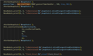

    Each call to App_startTimer will create a new timer. I noticed that most parts of the project do not have code to delete the timer before creating a new one. For instance, if FMNAP_startUTDetection is called repeatedly, two timers will be operating simultaneously.
    Can Util_constructClock be used to replace App_startTimer, as I've found that App_startTimer consumes an extra 50 bytes of memory?
  • isMaintained:7392
    isMaintained:7080
    isMaintained2:7080
    isMaintained2:6968
    Clock_Struct:96
