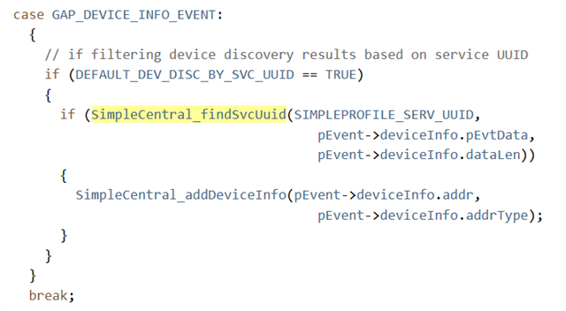

  • Hello Kim,
    What SDK are you working with?
    I would suggest taking a look at the simple_central example. This example filters based on finding a given UUID in an advertiser's service UUID list, and it could be a good reference for your case.
    You can also have a look at this section of our user guide for more information on whitelists: Filter Accept List.
    Let me know if this helps.
