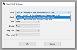

We are trying to run BTOOL (C:\ti\simplelink_cc2640r2_sdk_5_30_00_03\tools\blestack\btool)
on BLE stack((simplelink_cc2640r2_sdk_5_30_00_03\examples\rtos\CC2640R2_LAUNCHXL\blestack\host_test) )
CC2640R2F launchpad but with CXE build flag (WCSP setting).
But it fail like this: Device reset timeout.
Do we have any inconnect setting?
  • Hello Aichi,
    I am assuming the host_test project was successfully flashed into the device.
    What COM port are you using? Please double check it is the UART one.
    Let me know,
    David.
  • Yes, i have select correct com port.
    i had re-plug usb to tried again then meet below, any idea?
    BTW, i am using this prebild image:
    C:\ti\simplelink_cc2640r2_sdk_5_30_00_03\examples\rtos\CC2640R2_LAUNCHXL\blestack\hexfiles
    And whole thing will be ok if use BLE5 image.
