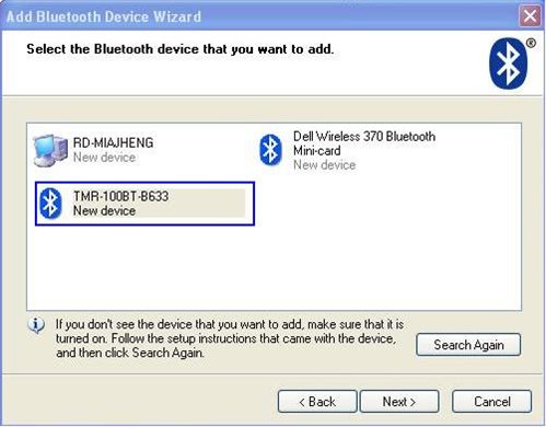

  • Hi Gustavo ,
    #define SDK_CONFIG_DEVICE_NAME                  "BlueMSP-Demo"
    it is right ,
    this define change DEVICE NAME "TMR-100BT-".
    example figure 1, blue frame.
    ( figure 1)
    but, i want to change SPP name(BlueMSP430) in services item.
    example figure 2, red frame.
    ( figure 2)
    thanks.

  • Dunk,
             I apologize I made a mistake in my previous post. Both files, db_gen.c and db_gen.h are provided as source in the SDK (I just double checked). You should modify the Service Name defined in the const UCHAR value_arr[] array in the db_gen.c.
    C:\Texas Instruments\MSPEXP-PAN13xx SDK\GA 1.0\MSP430-CC2560_Applications\Source\bluetooth\export\common_appl\db_gen.c
    C:\Texas Instruments\MSPEXP-PAN13xx SDK\GA 1.0\MSP430-CC2560_Applications\Source\bluetooth\export\common_appl\db_gen.h
    ~Miguel

  • Hi Miguel,
    I revise the Service Name to succeed.
    I checked "MSPEXP-PAN13xx SDK" file, it  is provide db_gen.c.
    Therefore, i try a way.
    From "MSPEXP-PAN13xx SDK" In the file, copy "db_gen.c" to "MSP430BT5190-CC2560 SDK" In file.
    "db_gen.c" add in project, then "built all" is pass.
    then i checked Service Name which already to change.
    This method is feasible.
    thanks.
