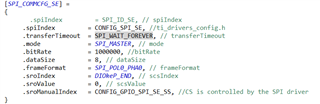

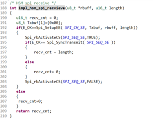

  • hi,
        1.The SPI cfg:
     2.We call the following api to receive SPI data:
    3.How to ensure that RX is ready?

  • hi Nima,
            Our SPI transmission is a synchronous mechanism. The receiving and sending interfaces are called in the same task. There is no case that the receiving is called before the sending is completed. Please also provide the reason for the possibility according to the overrun by the spi register.
    SPI overrun occurs when SPI controllers send data to a peripheral before the RX data is read.
    Can you verify that the RX data is being read?
    Using a GPIO to indicate that RX is ready (that all data has been read and the RX buffer is empty) and having TX  read that pin, indicating that RX is ready to receive, should alleviate this error.

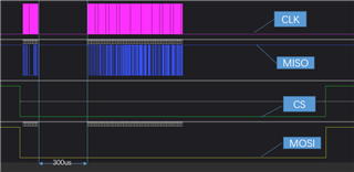

  • Hi , We measured the PIN of SPI and found that 300 us was interrupted in the middle of data transmission, which led to data failure. It was initially suspected that it was caused by abnormal interruption. We wanted to confirm whether the SPI driver in SDK was protected from interruption during data transmission.
  • Hi Sen,
    The DMA will handle this, so interruption should not be a concern. Are you using blocking or non-blocking mode? If a syn pin is used in polling mode, it should not be a concern either.
