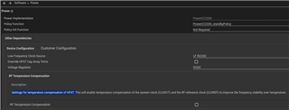

We are using the internal 32 kHz RC Oscillator (LFOSC) as a source for the low frequency system clock (LFCLK).
In the datasheet I read, that the accuracy of the LFCLK - derived Real Time Clock can be improved using the TI-provided power driver.
Could you please help me understand, how this is done?

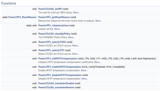

From the API of the CC2340R5 Power driver
I assumed, that it might be PowerLPF3_initHFXTCompensation / PowerLPF3_enableHFXTCompensation / PowerLPF3_disableHFXTCompensation.
In this case, I could enable the RF Temperature Compensation in the .syscfg file of my project.
But since the function descriptions do not mention any relation to the LFCLK, I suspect this is not correct?
Thank you very much in advance for any help you might be able to provide.

    I agree that the Datasheet footnote is not related to the *HFXTCompensation APIs currently in the Power TI Driver.  It could instead be alluding to CLK_01 errata (linked to the Q1 version since the CC2340R5 errata has not yet been updated) which as mentioned will be addressed in the v8.10 SDK which will release early Q2 of 2024.  I will ask the TI Drivers team for further comments
