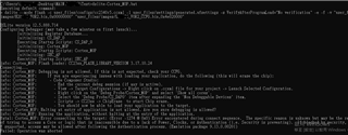

I am using dslite to program cc2340R5 but meet this issue.
I though it should just update ccfg, but not sure which part is incrrect.
Could you please help on this?
Thanks.

  • Sorry for my question is unclear, I mean if I got the IC in factory, nothing flash into cc2340, how do I do flash by dslite?
    We are using UniFlash Version: 8.4.0.4458 and SDK version 7_20_01_10
    Following  steps are our procedure for operation :
    1. Erase flash of cc2340r5 using UniFlash (Setting & Utilities -> Manual Erase -> Chip Erase) to revert the chip to its original state.
    2. Use UniFlash's Standalone Command Line -> Generate Package
    3. Run the generated dslite-Cortex_M0P.bat script.
    4. The displayed error is as shown in the image
    If there is already firmware in the chip, it won't fail, and it can be programmed normally through dslite,
    But chips intended for production should ideally have no firmware in their initial state,
    Do you have any ideas? Or could you teach us alternative methods to enable programming on the production line?

    New launchpads come programed with an BLE example on them already, but devices out of the factory do not have a firmware image. In order to flash devices that do not have any firmware image on them (no ccfg) there is a special setting that needs to be enabled (so dslite can first load through the debugger into the device), the setting is " --mode noConnectFlash".
    > c:\ti\uniflash_8.2.0\dslite.bat --mode noConnectFlash --config C:\Users\...
    Executing the following command:
    > "c:\ti\uniflash_8.2.0\deskdb\content\TICloudAgent\win\ccs_base\DebugServer\bin\DSLite" noConnectFlash --config C:\Users\...
    For more details and examples, please refer to the UniFlash Quick Start guide.
