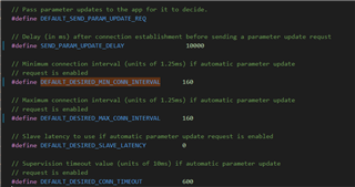

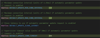

    I think it's a protocol stack issue, I don't see any data from Sniffer that the CC2642 is sending any connection parameter requests, the parameters I'm requesting are (Connection Interval 200ms, Connection Timeout 3000ms, and Latent is 0), and this fully satisfies the IOS requirements.
  • Wangrenli,
    Thanks for sharing your parameters, they do appear to satisfy the IOS requirements properly! Have you made any additional changes to the multi_role project or the sysconfig file?
    Luke
    Only the following two changes were made, I often try to change other parameters and the result is the same. The second modification is to also initiate a connection parameter request when doing a central device.
