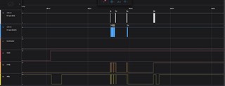

    1. Could you please provide some debug logs showing this "communication with the CC2640 getting stuck - no response back to the MSP on the UART and the watchdog then causes the reset".
    ANS. - We don't have any debug logs but here are some screenshots of the logic analyser trace showing the point where it stops and reset and one zoomed in a bit. What we have seen is that the MRDY and SRDY lines stay high. The second screenshot  "CC2640 last comms before device reset.jpg" show response to power init, we then send advertising, scan response data and then send scanning data and the start scanning command , we get the correct responses and 1 block of data which is incorrect length and that seems to cause the issue.

    /resized-image/__size/320x240/__key/communityserver-discussions-components-files/538/CC2640-comms-with-device-reset.jpg
    /resized-image/__size/320x240/__key/communityserver-discussions-components-files/538/CC2640-last-comms-before-device-reset.jpg

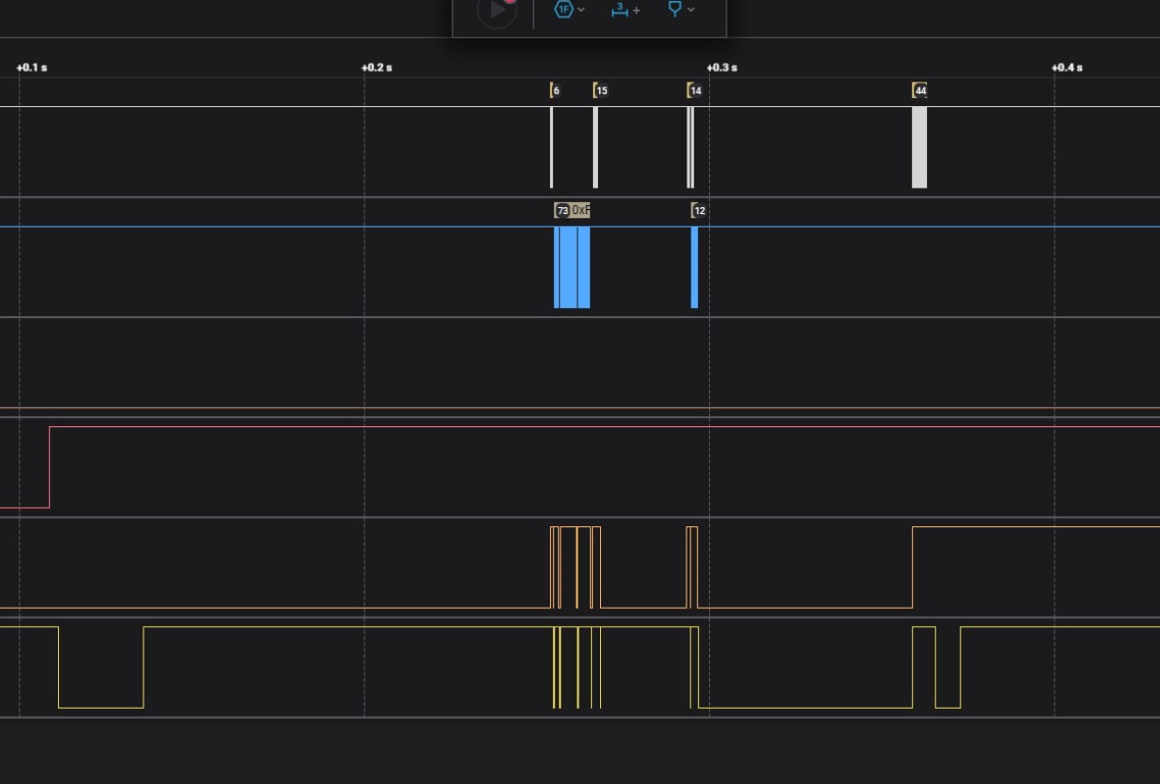

  • Hello Iain,
    Thanks for the information provided, sadly I cannot see the logic analyzer images, they are very small. I would suggest just copy pasting an screenshot of this traces into the post directly.
    Do you know where is this coming from?

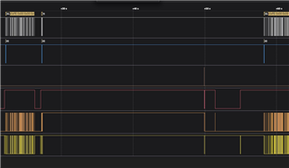

  • had some issues getting the images pasted into this. The block of data is from a device detected as to why it says length is 40 bytes but there is only 38 I do not know. this is the point at which it fails.
  • This is a zoomed out capture showing the last good data, the failure, reset and the re-start.

    Could you please specify (just by text is fine) what logic line refers to what exactly?

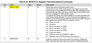

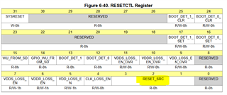

    Also, I think digging deeper into the reason of the reset can be helpful. The AON_SYSCTL:RESETCTL.RESET_SRC register should give us more insight about this. Could you please read it and share back the result? You can read more abut this in chapter 6.7 in the Technical Reference Manual
    BR
    David.
  • Looking at the screenshots and reading down in order the signals are all relative to the CC2640
    UART TX
    UART RX
    Bootloader input
    Reset input
    MRDY input
    SRDY output

  •  Hello Iain,
    The AON_SYSCTL:RESETCTL.RESET_SRCS register located in memory 0x40090000 shows the source of the last system reset that we can access after the device boots up again. Do you have a way of displaying information? What interfaces do you have?
