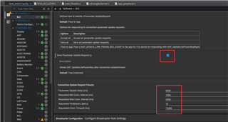

Question 1: about sending parameter update requests after connection establishment.
I made the following settings in syscfg,
When I used my mobile phone to establish a connection with the CC2340, I never saw a connection request update. According to the syscfg settings, the connection update should be executed six seconds after the connection is successful, but on the CC2340, I didn't seem to see it. this behavior.

  • Hello Weli,
    Thanks for reaching out.
    At the moment this feature (parameter update requests) is not implemented from SysConfig. However, you can use the out-of-the-box button menu (through Serial Terminal) to execute a GAP_UpdateLinkParamReq(). From your second question, I can see you are already following a similar approach. The status = 0x02 refers to INVALIDPARAMETER and based on a quick test I have done it happens when the connection latency is set to more than 1. I will double check this internally with the team and come back to you as soon as possible. Could you please try with .connLatency = 0 or 1 and let me know if you get a SUCCESS status (0x00) back?

  • Dear David,
    thanks for your reply.
    when i modify .connLatency to 0 or 1, it can return sucess(0x00).
    So if I need to change the connection interval after the connection is successful, I need to create a timer, and then execute GAP_UpdateLinkParamReq() after the connection is successful. right?
  • Hello Weli,
    Understood. Thanks for the confirmation.
    Yes, you can execute GAP_UpdateLinkParamReq() right after LINK_ESTABLISHED_EVENT using an interrupt callback function as it is done in the example.
