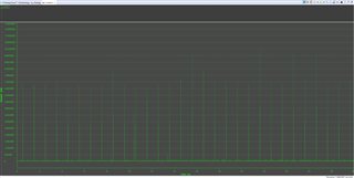

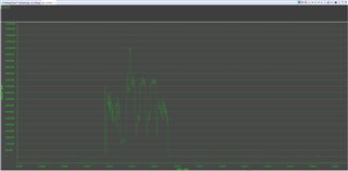

I have configured my peripheral device in periodic advertisement mode and want to understand a bit about the current waveform. I am referring to document on this link for developing understanding - Link

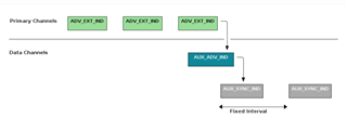

In the documentation, periodic advertisement process has following description -
I was expecting an extra peak in current waveform because of the AUX_ADV_IND sent on the data channel.
Does the peak in circle 5 represent the transmission on data channel and circle 2-4 represent transmission on primary advertising channel? Is it the right way to think about this?
Another thing I am not able to understand is why circle 2 (Which I am assuming is the transmission on primary advertising channel) is way higher than others. These waveforms are generated using energy trace in CCS IDE.

  • Garvit,
    Just to provide some more context for your provided screenshot of the waveform:
    - The un-circled peak at the beginning and circle 6 are representing the pre- (RTOS wake-up, radio setup, XTAL guard time) and post-processing/transition to Standby (BLE stack processes the received packets and sets up the sleep timer in preparation for the next event, and then goes to Standby).
    - Circle 1 (and possibly circle 2, although I am looking into this) are showing the radio preparation state where the radio is turned on and the transition to TX occurs.
    Circles 3-5 in your provided screenshot are all representing transmission of advertisement packets on each of the advertisement channels 37-39, respectively.
    I gave my assumption above about the high spike you are seeing but am going to spend some time looking into this to get you a more sure answer. For reference in the meantime,
    you can take a closer look at the Analysis section (6.3) and Advertising Event subsection (6.3.1) and its' contained Figure 6-13 and Table 6-1 for more details!

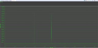

  • Hi Luke,
    This is the complete waveform output from energy Trace -
    I am seeing similar waveform again on enlarging the peaks -

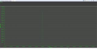

    Interestingly, there is another peak of around 10 mA near it -
    On enlarging that peak -
    On the Board I have kept only 3.3v, RXD pins. I am not sure what RXD and TXD pins represent but this was suggested in application note to get accurate readings hence I removed remaining. Can you tell me where I can read about these pins function as well?
    These are the readings from energy trace -

  • Garvit,
    After speaking with our internal expert, I have some answers about what you are seeing.
    First, on this point:
    This peak is due to the DCDC recharging the VDDR supply during standby. For best efficiency, during standby the system operates off of charge on the PCB capacitor on VDDR and periodically (perhaps once every second at room temperature), the DCDC is enabled and recharges that capacitor and then goes back into standby. This is described in Figure 3-1 in the app note referenced before.
    For your other question regarding the first peak about 3mA higher than the other peaks, it is likely that this is being seen due to a non-RF issue. This is coming from either flash access of the simple_peripheral project or due to the SW or RF drivers. This will require a bit more testing to understand exactly why you are seeing this spike.

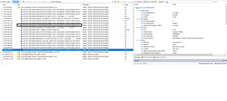

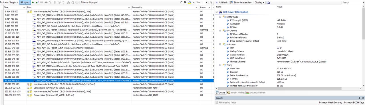

  • Hi Garvit,
    I took a quick sniffer log which did show the periodic advertisements over the air:
    I have also attached the recorded log: https://e2e.ti.com/cfs-file/__key/communityserver-discussions-components-files/538/PeriodicAdvertising.btt
    Jan

  • Hi Jan,
    I am struggling with opening of attached periodicAdvertising.btt file. Is .btt extension inherent to the sniffer device software you are using?
    From the attached Image, I am getting the confidence that periodic advertising functionality is functioning as expected but I am still curious about the log highlighted in black box in image below. The address adjacent to ADV_EXT_IND packet is different than the assigned device address.
    Also Jan, Is it safe to conclude that the current readings produced for the periodic advertisers are correct ?
    Garvit
  • Hi Garvit,
    No worries! The .btt file extension is used with the Ellisys packet analyzer software. This software is available for download on the Ellisys website. You should be able to download the software and open the file on your side. The readings look correct to me. I am not sure exactly what the different address may be, but its possible this is a scan response and its addressing the scanner address.
