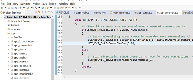

CC2340R5: After the Bluetooth connection, call the HCI_EXT_SetTxPowerDbmCmd function, the Bluetooth connection is disconnected and does not broadcast.
Part Number: CC2340R5
Hi team,
SDK version :7.40.00.64
Version REV B chip
The customer uses the service to modify the power after Bluetooth connection, and also directly uses the function HCI_EXT_SetTxPowerDbmCmd to set it. It was found that when the program ran this function, it ran away (Bluetooth disconnected and there was no broadcast). So it can't be modified after Bluetooth connection?

And I also reappear the customer's problem.
I added HCI_EXT_SetTxPowerDbmCmd(8,0); here, and found that the connection between the board and the mobile phone was disconnected, and the mobile phone could not scan the device.

    Using the function HCI_EXT_SetTxPowerDbmCmd to set the power is the correct way to modify the power after a Bluetooth connection is made. One thing you want to ensure you do when using this function is to add the function before enabling advertisements. You can look at the TI BLE5-Stack API Documentation for more information on the command but there is not any relevant routine description I have to share.
    Is the project this is being implemented in a custom project or one of the examples modified from the SDK?

    Looking at the screenshot you provided, moving the HCI_EXT_SetTxPowerDbmCmd(8,0) command before the BLEAppUtil_advStart() will likely give you more success as I mentioned before. You should do this prior to enabling advertisements for it to function as expected.
    Luke
  • Hi Luke,
    Modifying and adding functions during Peripheral_start() is indeed not dead, but after the connection, stop broadcasting, modify the  TX power, and turn on broadcasting, it will die.
