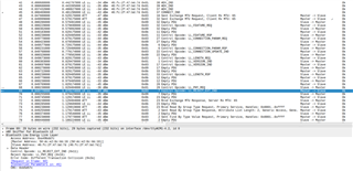

I am working with custom HW base on mentioned chip. Most of the code is based on simple central. Simplelink CC2640R2F SDK 5.30.0.03, slave device is Samsung A12.
The issue is when I try to send LL_CONNECTION_PARAM_REQ as soon as possible to make the initial handshake as fast as possible, other LL requests fail due to wrong sequencing of LL transactions (interleaving).
Some of these requests are probably sent by BLE stack itself (LL_FEATURE_REQ, LL_LENGTH_REQ,...).

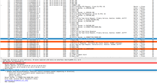

When I issue LL_CONNECTION_PARAM_REQ (capture@201) asap after receiving GAP_LINK_ESTABLISHED_EVENT, it get's mixed up with LL_LENGTH_REQ (capture@213), causing this request to be ignored by slave device resulting in 40 s timeout and connection drop. (same as in related forum thread)
wireshark capture screenshot with LL_LENGTH_REQ details expanded
Please see attached Wireshark capture for more details.ble_android_conn-param_response_connection_dropped.zip
Is there a way how to avoid breaking of LL requests sequencing? (e.g. some event from BLE stack to signal, when it's handshake/negotiations are finished)

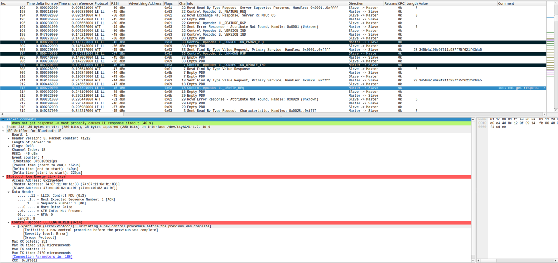

    For information, I cannot open the sniffer logs you have provided as they have been collected with a tool (competitor sniffer) I don't have access to.
    But, at first sight it seems the phone is sending a LL control procedure before the completion of the previous one.
    Could you please check if the same occurs with the Samsung S10E? Also, could you confirm this does NOT happen for the iPhone 12 Pro ?

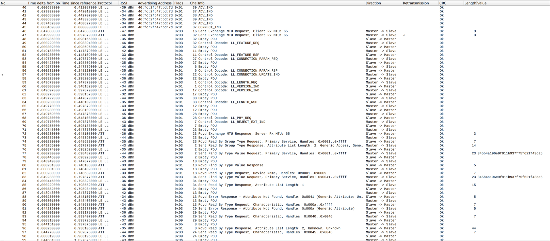

    iPhone 12 Pro:
    mostly fine, new connection timing is used since line 91
    This comment is actually incorrect. I should have written the "central" (CC2640R2F) device is sending a LL control procedure before the completion of the previous one. Apologize for this confusion.
    I am not sure this is actually a serious lead as the same can be observed on the iPhone log (lines 60 and 61 with LL_VERSION_IND are sent in the middle of the LL_LENGTH procedure).

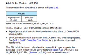

    Looking in the Samsung S10e log, I see the master/CC2640R2 send the packet LL_REJECT_EXT_IND. It would be interesting to gather more information about this packet. For example, which oppCode is being rejected and which ErrorCode is being reported.
    For sanity, please also check if phone supports the Extended Reject Indication Link Layer feature. This check can be done looking at the LL_FEATURE_RSP sent by the phone.
    I think these LL_VERSION_IND does not matter as they are not requests and do not require any response, thus do not collide with other LL transaction.

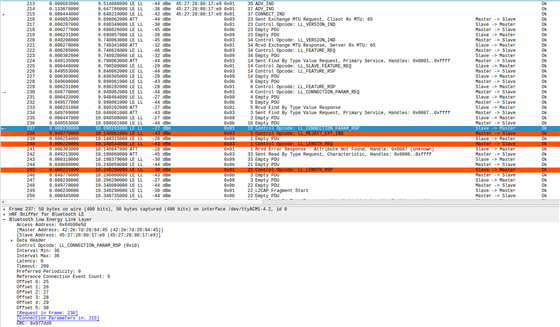

    S10e connection request related packets details:
    • Interval Min: 12
    • Interval Max: 40
    • Latency: 0
    • Timeout: 200
    LL_CONNECTION_PARAM_RSP
    • Interval Min: 36
    • Interval Max: 36
    • Latency: 0
    • Timeout: 200
    LL_REJECT_EXT_IND
    • Reject Opcode: LL_CONNECTION_PARAM_REQ (0x0f)
    • Error Code: Invalid LMP/LL Parameters (0x1e)
    I am not sure what CC2640R2F BLE stack does not like about those parameters in response.
    I have reviewed the content of the LL_CONNECTION_PARAM_RSP. The intervals specified, the latency and the timeout seem to be correct.
    For sanity, could you please check the value of the "reference connection event count" and of the offsets. To do this, you should ensure all these events are in the future (i.e. reference connection event count + offset is larger than the current connection event).
    In addition to this, could you please review the content of the LL_CONNECTION_PARAM_RSP sent by the iPhone? I would like to see if we can spot something that could put on a lead.
    Similarly, could you try to change the connection parameters requested to the Android phone? It would then be interesting to see if it has an impact.
    Last but not least, could you try to delay the connection parameters request?
