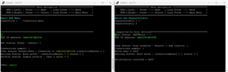

    Can you try setting the .sig parameter to true/1? This bit is the authentication signature status, so the command is likely being rejected because it is expecting this value to be 1.
    Jan
  • Hi Jan,
             I have tried setting the .sig parameter as TRUE now getting an status as an   bleLinkEncrypted                0x19  (The link is already encrypted).

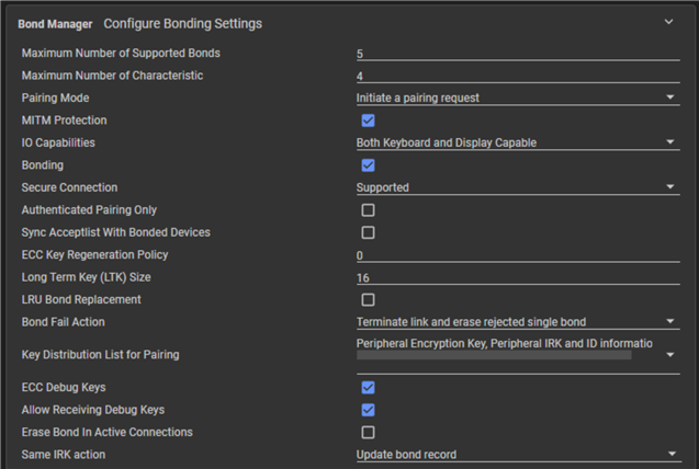

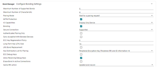

    For information : n syscfg pairing mode set has initiate pairing request in central and wait for pairing request in peripheral so pairing happens when  link has established .
    Configurations for the Bond Manager in SysConfig
    Peripheral:
    Central:
    Vignesh.

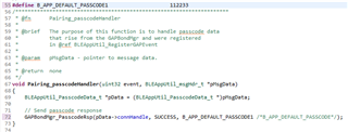

  • Hi Jan,
    Thank you for your response.
     When using the GATT_PERMIT_ENCRYPT permission central can able to enable the notifications and as well in mobile while enabling notification its going for an authentication(Pairing). After successful authentication notification has enabled as expected and thank you for the effort.
    Now I have changed  Basic_Ble_peripheral passcode as B_APP_DEFAULT_PASSCODE1  - 112233 with mobile while enabling notification its going for an authentication(Pairing). After successful authentication notification has enabled as expected  with updated passcode.
    But in central I didn't modified an default passcode and trying to connect with peripheral as expected pairing fail has to happen but pairing success and Bond save has happening. May I know how the pairing has happening from central and why central and peripheral didn't validate the passcode. In peripheral why Pairing_passcodeHandler function has not executed.
    whether I am missing or doing mistake from my side. Please let me know.
    And sorry I don't have any Bluetooth sniffer log to provide.
    I am using Gatt_client code without modifying  where I have already provided and in Basic_ble_peripheral have modified in B_APP_DEFAULT_PASSCODE1 in pairing.c and GATT_BT_ATT( clientCharCfgUUID, GATT_PERMIT_ENCRYPT_READ | GATT_PERMIT_ENCRYPT_WRITE,  (uint8 *) &simpleGattProfile_Char4Config ), in simple_gatt_profile.c.
    Vignesh.

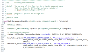

  • Hi Jan,

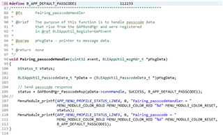

         I have performed freshly code loaded modules for testing so there is no any bond save happen previously.
    Yes, I have created an #define B_APP_DEFAULT_PASSCODE1         112233  in pairing.c (Basic_ble_peripheral)
    SDK file I didn't modified an  B_APP_DEFAULT_PASSCODE   where 123456.
    Vignesh.

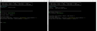

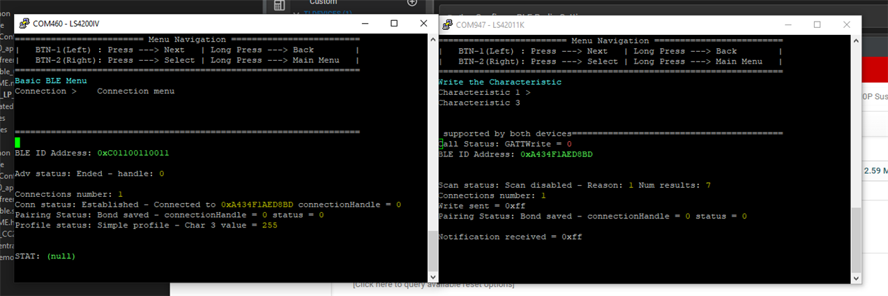

  • Hi Vignesh,
    I was able to reproduce the behavior you are seeing. Interestingly, even though the pairing success was seen. The peripheral does not allow the characteristic to read Char 5 which confirms the pairing was not accepted. I did a quick test with my smart phone and put in the wrong pin upon being prompted and got the following log:
    https://e2e.ti.com/cfs-file/__key/communityserver-discussions-components-files/538/FailedPairPhone.btt
    Which shows the pairing failing. This is expected.
    When testing with your project, it seemed that the central was in charge of pairing and it went by its rules. However, I tried changing the IO capabilities of the central device and that seemed to fix the issue. The pairing fail would be seen over there as shown in the following log:
    https://e2e.ti.com/cfs-file/__key/communityserver-discussions-components-files/538/displayAndKeyboardIOCapabilities.btt
    Jan

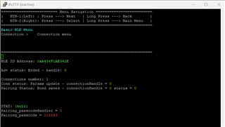

  • Hi Jan,
     Sorry for the late response.
    I have tested by changing the IO capabilities of the central device as Both Keyboard and Display Capable and pairing failed as expected.
    Now setting the both peripheral and gatt_client passcode as #define B_APP_DEFAULT_PASSCODE1         112233 where
    Pairing Status: Started - connectionHandle = 0 status = 0  to
    Pairing Status: Bond saved - connectionHandle = 0 status = 0 its takes approx. 104 seconds to complete the pairing and bond save. But pairing has to complete less than 10 sec but its taking 104 sec approx. may I know why? or I have missed something?
    May I know which IO capabilities need to update in both central and peripheral.
    Vignesh.

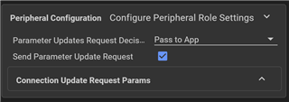

    To speed up pairing, you can try disabling the "Send Parameter Update Request" option in SysConfig:
    I have tried but still takes approx. 104 seconds to complete the pairing and bond save.

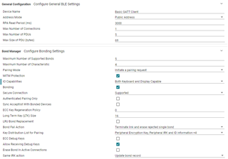

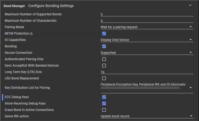

  • Hi Jan,

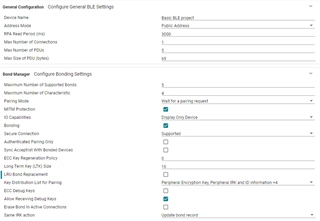

    Thank you,
    Could you provide me with the exact pairing and bonding settings you are using?
    Here the images of bond settings in basic_ble and GATT_client
    GATT_client:
    basic_ble:
    I have tried where
    Here our  actual requirement is Basic_ble IO capabilities- Display only device and Gatt_client IO capabilities was No Display or Input Device. We are trying to pair with default passkey.
    Vignesh.

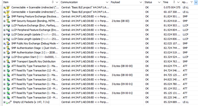

  • Hi Vignesh,
    I took two basic ble projects and made one the peripheral and the other the central. The only modifications I made were the following sysconfig changes:
    Central:
    Peripheral:
    However, pairing time was fairly quick. Over the air I saw the following:
    Which shows pairing completing in a few seconds. I have uploaded the projects below:
    basic_ble_Peripheral.zip
    basic_ble_central_project.zip
    Can you see if you observe the same pairing delay on your side? If not, then could you provide me with your projects to test on my side?
