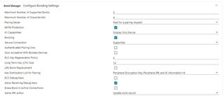

  • Hi david,
            Thanks and here the details for your questions
    • What you are describing is happening after only saving and then erasing 1 bond?
                    -Yes, for testing in central we are saving bond of one peripheral device and erasing bond information only in central while disconnecting.
    • Who starts the paring/bonding process (central or peripheral)?
                    - In syscfg pairing mode set has initiate pairing request in central and wait for pairing request in peripheral so pairing happens when connected with link has established .
    • Have you done any modifications to either of the two projects (basic_ble and basic_ble_GATT_client) other than adding the GAPBondMgr_SetParameter(GAPBOND_ERASE_ALLBONDS, NULL, NULL) in the Menu_disconnectCB()  for basic_ble_GATT_client?
                    - we  didn't modified the code except the pairing mode in both central and peripheral and bond erase in central.
    • What configuration do you have for the Bond Manager in SysConfig?
    Peripheral:
    Central:
    And sorry for an mistake I have using an basic_ble_GATT_client in SDK version
    SDK Version : simplelink_lowpower_f3_sdk_7_20_01_10(peripheral and central)
    CCS version: CCS 12.5.0
    Where custom application using an SDK version
    SDK Version : simplelink_lowpower_f3_sdk_7_40_00_64 (peripheral and central)
    Vignesh.

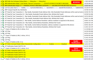

  • Hello Vignesh,
    Thanks for the answer.
    I have conducted a series of tests: 1) using basic_ble configured as both central and peripheral, 2) using basic_ble configured as peripheral and central configured with host test with BTool, 3) using basic_ble configured as peripheral and basic_ble_GATT_client configured as center. In every test the Peripheral is config as "Wait for a pairing request" and the central to "Initiate a pairing request" as in your case.
    I am not able to reproduce your case so far with the steps we discussed:
    • Central (executing basic_ble_GATT_client) connects to Peripheral (running basic_ble).
    • Both devices pair and bond (Pairing Status: Bond saved).
    • Central enables and receives notifications.
    • Central disconnects from peripheral and erase ALL bonds through GAPBondMgr_SetParameter(GAPBOND_ERASE_ALLBONDS, 0, NULL).
    • Central connects to Peripheral.
    • Central enables notifications
    • Pairing Status: Bond saved changes to Pairing Status: Encrypted on central and peripheral.
    • Central can send data through GATT_Write to peripheral characteristic 3, which will echo the same data through the characteristic 4 as a notification.
    FYI: The notification data is not encrypted as I am using ECC Debug Keys.
    Attached are some of the Bluetooth sniffer logs.
    First Connection and Bonding:
    After erasing the first bond (ERASE ALL BONDS) and generation a new connection and bond:
    Central (when the previous steps are finished):
    Peripheral (when the previous steps are finished):
    Pleas help me with the following questions:
    1. Could you please share a bit more about the notification issue you have?
    2. What characteristic are you writing to for the notifications?
    3. How do you know it is not sending any notification?
    4. Are we missing a step here? Could you please double check the steps I am following to reproduce this?
    David.
