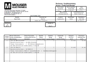

  • The experience you've shared is certainly not expected.  Please provide the following:
    • How many LP-EM-CC2340R5 and LP-XDS110 units (each as a total of units tested) which are not working out of box.
    • Whether the suggested mitigation suggestions resolve the problems for each.
    • The source from which you obtained the faulty LP-EM-CC2340R5 and LP-XDS110 boards (TI.com, distributor, etc).
    • The CC2340R5 chip markings, LP-EM-CC2340R5 and LP-XDS110 board versions, and CC2340R5 chip version reported by UNIFLASH.
    Through obtaining this additional information it may be possible to help prevent further occurrences.
    Ryan
  • Here you go, again since at least on paper these ICs are interesting I would suggest you to replace
  • Please understand that Mouser is a distributor for TI, and as such I recommend that you contact Mouser to work on replacements and to determine whether the boards could have been altered from their intended factory settings before being shipped to you.
    This forum should still be utilized to determine whether these boards can be recovered and operate after re-flashing their respective firmware.  If this is successful then the ICs/parts themselves are not faulty.  Are you planning to use LP-EM-CC2340R5/LP-XDS110 hardware directly in your final product?  This would be atypical, as custom board implementations are the expected goal for product development.

  • I just wanted add a note here to possible other readers the defected parts were replaced for us by mouser
