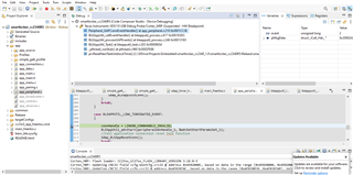

  • Hello Clement, the issue number 1 occurred and I have connected the debugger, we are receiving BLEAPPUTIL_LINK_TERMINATED_EVENT as attached. The only way to recover is reset or flight mode on/off on tab (not sure if this happen immediately or after couple of terminations though, but eventually central device gets to this state, right now do not wish to test this by resetting board before your further advice on this). Please suggest what are the parameters to monitor now and also potential fix to recover this situation.
    When receiving the BLEAPPUTIL_LINK_TERMINATED_EVENT, you also receive a pointer to a BLEAppUtil_msgHdr_t structure (pMsgData) that can be cast to a gapTerminateLinkEvent_t structure. The "reason" field of the same structure should help getting a better understanding of issue.
    Here is a short code snippet showing the same. You can also reference the file app_connection, which, by default, implements the same.
            case BLEAPPUTIL_LINK_TERMINATED_EVENT:
                gapTerminateLinkEvent_t *gapTermMsg = (gapTerminateLinkEvent_t *)pMsgData;
                volatile uint8_t reason = gapTermMsg->reason
    I hope this will help,
    Kind regards,
  • The reason is 62 (LL_STATUS_ERROR_CONN_FAILED_TO_BE_ESTABLISHED?) in this specific case, normal disconnect is 22 (LL_STATUS_ERROR_HOST_TERM)
    Connection termination reason 0x3E (62) corresponds to "Connection Failed To Be Established".
    Connection termination reason 0x16 (22) corresponds to "Connection Terminated By Local Host"
    Here is what the spec says about 0x3E (BLUETOOTH CORE SPECIFICATION Version 5.3 | Vol 1, Part F, §2.59):
    A "Connection Failed To Be Established" reason should be sent by the peripheral in the two following cases:
    • case 1: If connection created but not established, and received a request with incorrect access address
    • case 2: If connection created but not established for Direct Advertisement, but no data packets received ==> Are you using Direct Advertisements? (I don't think so when reviewing your code but let me know if I have missed it)
    Case 1 could also explain why the device remains connectable by other phones. What are your thoughts?
