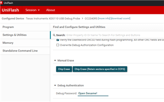

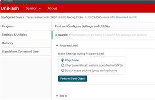

And he try to use uniFlash for Chip Erase he will show:
How to flash it?
Yolande
  • Hello Yolande,
    When you use Uniflash, can you enter the Setting & Utilites tab, and do "Perform Blank Check" this should erase the device, and allow us to program it.
    From the error log it looks like there may have been a program flashed on the device which disabled the debug, as that is a setting you can set in syscfg.
    Alex F
  • Hello Alex,
    I try to do "Perform Blank Check" , but it show me that
    cant execute Chip Erase

  • Hello,Alex
    I has try to maunal chip erase , but it show me this message
    Do you mean I set Debug Password with "debug locked" , then CC2340 can be erase ?
    Ryan
  • Hello , Alex
    I try to set Debug Password with " debug locked" , then I click to Chip Erase
    But it show the same
  • Hello Ryan,
    I think the following post gives some good information on what is going on here, https://e2e.ti.com/f/1/t/1309689/.
    -It seems like the device might have been set to either debug locked, or debug authorization with password.
    -In the first case we unfortunately cannot access the device or erase it.
    -In the second case we need the authorization password to be entered into Uniflash, however we would need to know the password beforehand; else the device will stay locked.
    Do you still have the project that this device was programmed previously with? We should be able to check the password in the CCS project.

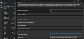

  • My SDK version is 7_10_00_35
    and I use "uart2callback_LP_EM_CC2340R5_freertos_ticlang"
  • Hello Ryan,

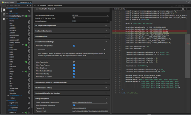

    Navigate to your syscfg -> Device Configuration -> Debug Configuration, and you should be able to change the debug to "Require debug authentication" or check if this is the setting already; then try the password listed in Uniflash. The debug authorization password works with the project the device is currently programed with, so if the uart2callback is rather the new project to be flashed (rather than the project currently on the device) it will not work.
    Alex F

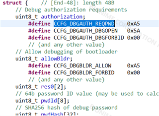

  • I try to set Debug Configuration ->  "Require debug authentication" , then I build this Project that display error.
    I find "hw_ccfg.h" to be define CCFG_DBGAUTH_REQPWD , but "ti_devices_config.c" is set CCFG_DBGAUTH_REQPASSWD, so I do not build
  • Hello Ryan,

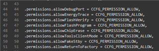

    Can you check the following settings in your ti_devices_config.c file?
    (yours will be different, as this project's syscfg is allowing debug)
    The CCFG_DBGAUTH_REQPWD (ccfg debug authorization require password) and CCFG_DBGAUTH_REQPASSWD (ccfg debug authorization require password) seem very similar, if not the same (I may need to reach out to an internal team to confirm this).

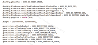

  • My ti_devices_config is setting :
  • Hello Ryan,
    So the .permissions... are controlled by the "Device Permission Setting" field, which it looks like you have set to default (where everything is enabled).
    When you say, "then I build this Project that display error." do you mean after you change the device configuration to require debug authorization and you re-build your project you see an error when building appear and cannot download the project? Or are you specifically referencing the error that you cannot chip erase/download anything on the CC2340R5 you discussed above.
    -If it is a build error check if you made any changes to the uart2callback example, you could try to open another uart2callback example (but only change the debug configuration to require authentication) and see if it errors still; if it does not error that could point to some issue in your custom modified project of uart2callback.
    -If your error is in regard to the chip erase/download, are you sure that the Password ID and Password Hash has been unchanged since you first loaded the project? Try both the password ID and password hash in the UniFlash debug authentication field then re-try the Chip Erase.

  • I try to load other Project , but the same. So I think this is not Password Error.
    I use Perform Blank Check that show me
    Before this happened to me, it seemed that I accidentally interrupted the burning process, causing a window to pop up, but the command prompt window did not display anything. To be precise, it only had the border of the window.
  • Hello Ryan Li,
    After discussing with my internal HW team, you are unlikely able to recover the device if you cannot perform a mass erase, and given the things we have tried so far did not work. The device may have incurred some issue when interrupting the device during flash.
    Alex F
