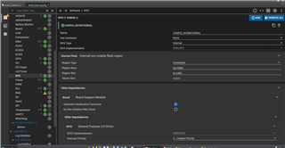

Hello Ryan,
To configure the address of the hex file you should use the NVS module in the Syscfg, then re-download and flash the hex file(s).
Alex F

Hello Ryan,
I wanted to ask what you wanted to specifically achieve here by exporting the memory (the purpose)?
If you still have the original project handy in CCS modify the NVS region to specific your target address, rebuild, and then try flashing/loading in Uniflash.
