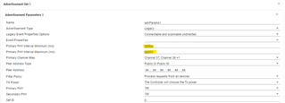

I’m using basic_ble and by default the CC2340 advertise every 100ms.
the advertisement period is too low, and I want to increase it to 30 seconds.
I searched in sysconfig file and I was able to find an option to change the advertisement time and changed it to 30 seconds.

    This can be done during runtime by using GapAdv_setParam() function. The Scanning and Advertising Basic SimpleLink Academy lab walks you through this process and provides valuable information on how to change any parameter during runtime.
