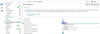

    3- You can use SysConfig to change the LF clock source (and use the RCOSC as LF clock source).
    Using a clock "Derived from HF XOSC" will provide a very accurate LF clock, but prevent the device to go to low power mode (i.e. significant impact on the total power consumption).

    3) in my example, this is greyed out, says "sysconfig cannot be used for this example"

    1) You should ensure the symbol USE_RCOSC is defined in your project. This can be done using SysConfig > BLE > Advanced Settings > Use RCOSC. This will then ensure the proper calibration and SCA are set (if you are curious look for the "USE_RCOSC" symbols inside project_zero.c).
    Note that you will probably receive a benign warning message (see #3 for steps to solve it).
    3) True, as the project_zero is an OAD-enabled project, the CCFG is held by the BIM project. In the BIM project, the configuration should be made per the description provided in my previous message.
