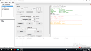

    This is the log output from btool:
    [1] : <Info> - 09:24:24.048
    Port opened at 2024/2/29 上午 09:24:24
    [2] : <Tx> - 09:24:24.186
    -Type : 0x01 (Command)
    -OpCode : 0xFC1D (HCIExt_ResetSystemCmd)
    -Data Length : 0x01 (1) byte(s)
    Type : 0x00 (0) (Chip Reset)
    Dump(Tx):
    0000:01 1D FC 01 00 .....
    [3] : <Error> - 09:24:26.216
    Message Response Timeout
    Name = HCIExt_ResetSystemCmd
    OpCode = 0xFC1D
    Tx Time = 09:24:24.186
    [4] : <Warning> - 09:24:26.217
    Device Reset Timeout
    Device May Not Function Properly

  • Hi Preston,
    Got it. The log you are seeing is typically seen when the device if flashed with host_test, but not reset before being connected to btool. Are you using an LP-EM-CC2340R5 or a custom board?
