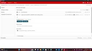

I am using SDKv7.10 and Uniflash 8.1.1. What load address should I set it to?

Hi kel,
project_zero uses off-chip OAD, and in either instance the application binary uses the default load address of 0x0 since the BIM is stored in the last page of flash memory. The image you've provided appears to be the correct Uniflash setup. Here is the BLE Enhanced OAD Fundamentals SimpleLink Academy Lab and OAD Section of the BLE5-Stack User's Guide for further review.
