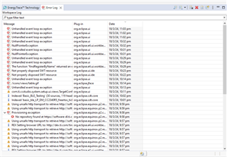

Also, I tried to run an energy trace to see the power number but it is not working.

    For Energy trace, it opens a small window called progress information see attached image. Once it gets complete it is not giving anything apart from that.

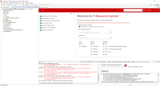

  • Hi Jan,
    Now i am getting error as seen in attached image.
    Got it. Thank you for providing these logs. Are you using a LP-EM-CC2340R5 as your dev board? Also, how did you install the SDK? Did you install it through the TI Resource Explorer or through the .exe installer available on ti.com?

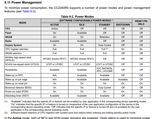

    The power manager will place the device in the lowest mode possible depending on what is running. For example, if driver is always active and preventing standby, then the power manager will not be able to achieve standby and at most will go down to idle. You cannot force the power manager to override the driver. However, you can close the driver or configure the driver to allow standby. Some additional information about this may be found in the Power, Reset, and Clocking section of the TRM. Section 9.11 Power Management of the datasheet contains a table that provides information on the lowest power setting each driver and peripheral allows while it is active:

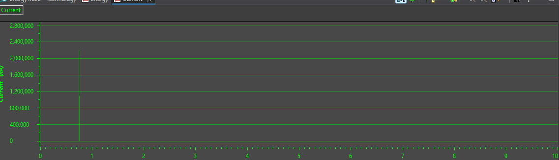

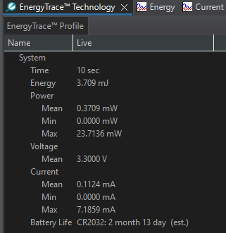

    I tried to debug using debugger to check weather it really goes into power down mode or it really comes out from that or not and i can see that it is not happening. Also, I am able to use power trace properly now but only when using debug and by looking at current and power graph also i can not see any low power activity. I really need to understadn that how it happen in Code Examples (CEs) mainly in basic BLE.

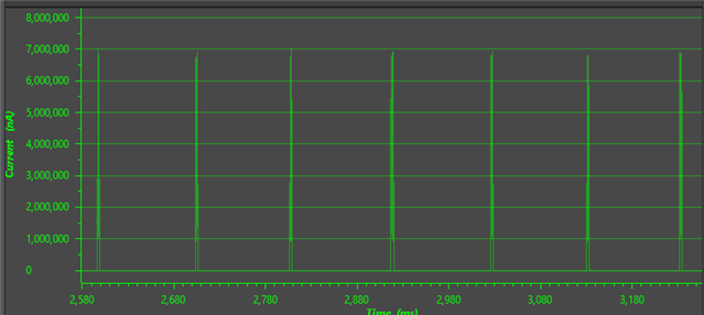

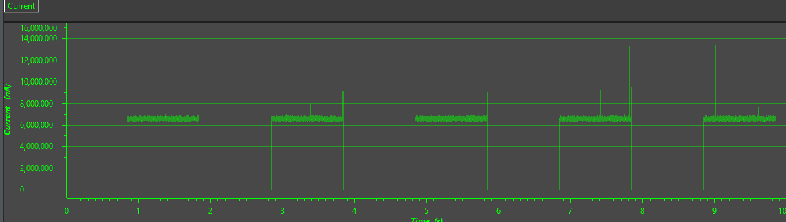

    Using this procedure, I measured the power draw for the empty example and generated the following data (this is with the red LED jumper connected):
    With the LED jumper disconnected, we see the following figure:

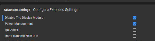

    dWhen measuring power draw, ensure the display is turned off in SysConfig:

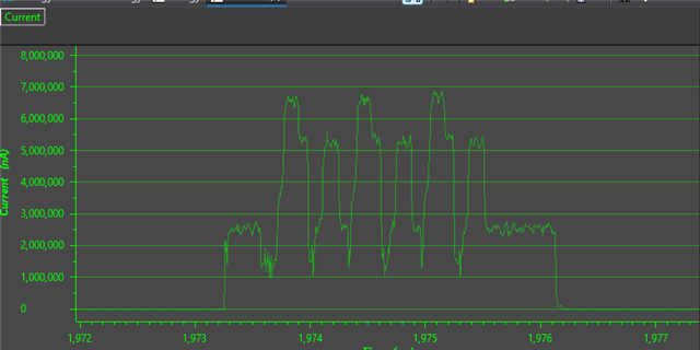

    Zooming in we can see individual advertising events:
    Between advertising events, we can see the power level go to standby:
    As you can see, when the device is not performing BLE activity, the device goes down to standby and the current goes to the nano amp level.

    No modification done apart from changing the device MPN and disabling UART and Display.
    Also, I am still facing the issue with energy trace and it is not opening without using the debug session. Throws error as per below image.
    and
    Fresh Basic BLE Code Example current consumption on DMM is ~1.5mA (changes between 1.46mA to 1.5mA)
    Also, I have seen on your image that it says Y-Axis as Current (uA) which I can not see anywhere in my energy trace. Can you provide guide to set that.

    1.) Is there any way to use energy trace to monitor the power and take the battery estimates?
    EnergyTrace is mainly used to monitor the power and is able to provide battery estimates based on provided battery information (by default battery life for a common coin cell is provided).
    2.) Is there any other way to identify that whatever Code Example I am using, goes in power saving mode?
    The main way to detect power saving mode on the CC2340R5 is to observe the power draw associated with standby. Using some power driver functions, when the device wakes up you are able to determine which mode it is waking up from, but this does not tell you which mode it is currently operating in. When the device is running in standby, it is NOT executing any application code.
