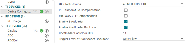

hi expert,
How can I config bootloader backdoor at build environment linux, gcc and source is from git hub?

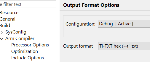

Hi Expert,
How can I output hex format at build environment linux, gcc and source is from git hub?

Hi Frank,
What TI GitHub resource are you using? I am going to assume ot-ti based on your relevant thread: https://e2e.ti.com/f/1/t/1332982
As such, src/openthread.syscfg Device Configuration changes are applied during the next build and will be reflected in the .out file generated. CCS uses tiarmobjcopy to convert .out files to the .hex format, thus you can choose to accomplish the same.
