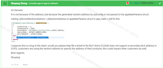

I use
and set
Then use IOS and Android phones to test respectively.
Android phone: There is a broadcast, and the address on the broadcast display has been changed to CF, FF, FF, FF, FF, CF, but connect cannot connect to it.
IOS phone: Cannot scan the broadcast
Is there any other way to successfully change the MAC Address and scan and broadcast successfully?

  • The goal I want to achieve is to be able to change the MAC Address during execution, and to be able to update on the broadcast and successfully connect.
    The MAC Address will no longer change after the update, so RPA mode is not considered.
    If the product is mass-produced later, it is impossible to use Syscfg to reset the MAC Address every time.
    Currently using SDK: 7_10_00_35, the development has reached a stage, and we are not considering using SKD: 7_40 for the time being.
    1. It is indeed possible to customize the Device Address using the Random Address Mode of .Syscfg. However, as mentioned above, it is impossible to open CCS every time during mass production to change the Random Address of .Syscfg. Is there a way for me to do this? Device Address is successfully changed directly during execution?
    2.If, as you said, the Address is updated on the broadcast but remains connected when connected, it is because the Syscfg setting conflicts with HCI_EXT_SetBDADDR(). Then I set the Random static Address in Syscfg, then use HCI_EXT_SetBDADDR()? Will there be no connection problems?

  • I will explain in more detail why I want to modify the MAC Address. I hope that after you understand my needs, you can give me a solution that better meets my needs.
    Our company has the MAC address for purchasing Bluetooth. That’s why we hope that the product can be modified to the MAC address we purchased, and that it can successfully adversiting and connect. However, it has been confirmed that the Public Address of CC2340 cannot be changed, so I would like to ask if there is a way to do this without going through Syscfg and Have any way to modify the MAC Address ?. The reason why you don’t want to use Syscfg is that when the product is in the mass production stage, it is impossible to use Syscfg to change it every time.

    I now understand that Random Static Address is not what I want, Public Address is. After all, Public Address is fixed and will never change, but there is no method or software to change the Public Address of CC2340?

  • Hi Ryan,
    I have some initial findings in order to help you implement a way to specify your own public address.
    1- Set the device to use Public address
    2- After the stack initialization (in App_StackInitDoneHandler), call HCI_EXT_SetBDADDRCmd. Note that no other Bluetooth operation should be started before the address has been set (i.e. HCI_BDADDR_UPDATED_EVENT has been received)
    Let me know how it goes.
  • Hi Clément,
    I try to set HCI_EXT_SetBDADDRCmd() after App_StackInitDoneHandler() as shown below ,then I checked two phones with different operating systems.
    Andriod : 1.Advertising is OK
                    2.but Public address not be changed
                    3.can be connect
    IOS :1. Advertising is OK
             2.T
    he IOS system cannot view the Address , so I do not check it be changed
             3.it can not be connect (  always connecting )
    PS . appInitDoneHandler() = App_StackInitDoneHandler() in bleapputil_process.c
  • Hi Ryan,
    I am a bit confused. In the code you have shared, it seems the address modification is not done in App_StackInitDoneHandler() as suggested. To me, this is a problem because you cannot be sure the address is set before the advertisement is turned on.
    I have tested the same on my end. No connection issue found and the address displayed on Android devices is correct.
    Here is the process I have followed:
    1- Set the device to use Public Address in SysConfig
    2- Ensure you find a valid Public Address (I used 14:A0:CC:D0:C7:E5)
    3- Add the following code at the beginning of App_StackInitDoneHandler
        hciStatus_t addrStatus;
        unsigned char newAddress[6] = {0xE5, 0xC7, 0xD0, 0xCC, 0xA0, 0x14 };
        addrStatus = HCI_EXT_SetBDADDRCmd(newAddress);
        if(addrStatus != HCI_SUCCESS)
            while(1){}
        sleep(1);
    I hope this will help,
  • I success !
    It turns out that HCI_EXT_SetBDADDRCmd() was called at the beginning of App_StackInitDoneHandler(). I originally tried to call HCI_EXT_SetBDADDRCmd() after calling App_StackInitDoneHandler().
    Thanks,Clément !
    I still have some questions. Does the function HCI_EXT_SetBDADDRCmd() directly modify the MAC Address in FCFG? Or does it modify the read MAC after reading the MAC Address of FCFG?
    Thank you for confirming!
    HCI_EXT_SetBDADDRCmd() only modify the address used by the BLEStack, but it does not alter the MAC Address in FCFG.
