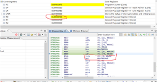

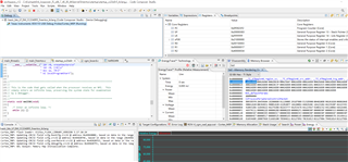

  • Hi Ryan,

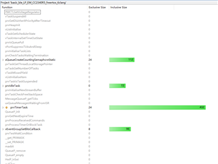

    Our own project is OAD. Since direct writing can not start, so try this debugging method, found that it can start normally, it is suspected that Boot or Persistent problems. So I want to find a direct start project (basic_ble) to verify, found that after burning can not start, direct debugging did not have any reaction, the following is the basic_ble project direct debugging state. However, the debugging method of OAD can be started normally.
    In addition, we suspect that the 48MHz crystal oscillator is the problem, we also put the previous version (using CC2340R5RKP) can normally start the crystal oscillator replaced on this board, still can not start.
    There is no LED on our board, but I tried to initialize the high and low output of gpio inside after starting up, and there was no change in the multimeter test.

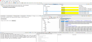

    Above is the state of basic_ble project debugging when paused.

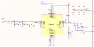

  • Here are some of our schematics:

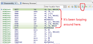

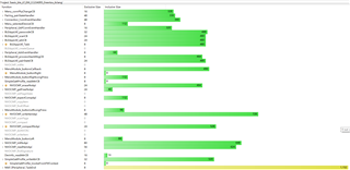

    In addition, while debugging the basic_ble project directly, the code has been running the following code in a loop.

  • This certainly appears to be related to the custom hardware design.  I will loop in a HW colleague to advise as such.

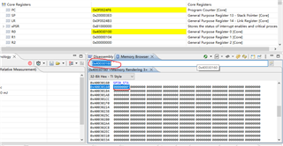

  • Hi Ryan,
    Did your HW colleague reply?
    I found the following problem while debugging. Take a look at this code(ldr r0, [r0, #0x60]). The value of R0 is 0x40030100. Check 0x40030160 Memory value is 0xf. 0x40030160 should be the STA register inside the SPI register.
    Why check the STA register in SPI when starting?
    Billy
  • I will ping HW to respond.  You findings depend on the image which has been loaded onto the device.  For instance, SPI would be referenced if debugging an off-chip MCUboot solution.  Loading project symbols and reviewing the call stack when the debugger is paused will give you further insight.

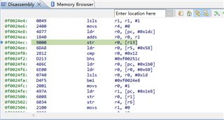

  • I'm using the basic_ble project. Does CC2340R5 have boot code built-in? Running from boot code?
    The above debugging I call step by step.
    Billy
  • "basic_ble" implies no OAD.  SPI is used to shut down external flash during start-up for LaunchPad boards.  If you do not have an external SPI connected then you should remove the "Generate Initialization Functions" checkbox from basic_ble.syscfg -> TI DRIVERS -> Board inside the SysConfig editor.  I would have expected this to already be accomplished or else your CC2340R5RKP board version would have experienced similar issues.  Otherwise, SPI is not used by the basic_ble project.

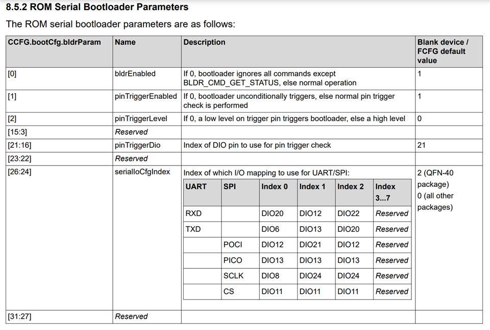

  • Have you programmed the CCFG to enable the bootloader, and are you enabling the backdoor bootload pin during device reset?

  • Hi Ryan,
    After I changed the setting value of Bootloader Configration to "Any bootloader forbidden", the program can run normally.
    Is the default bootloader on the System Rom? Why does the same program with the same CCFG configuration work on the CC2340R5RKP but not on the CC2340R5RGE?
    Thank you very much.
    Billy
  • Hi Billy,
    I had momentarily forgotten that the default bootloader configuration is pre-determined on the CC2340R5 by the FCFG.  It was good of you to try disabling the bootloader entirely.  From the TRM:
     Thus if DIO 21 is held low during a reset.  You can avoid this by configuring a new bootloader pin setup in CCFG or disabling the bootloader altogether, as you've shown is effective.
