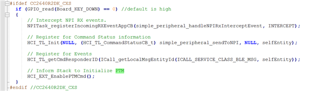

My customer based on this link to add PTM feature into project.
C:/ti/simplelink_cc2640r2_sdk_5_30_00_03/docs/blestack/ble_user_guide/html/ble-stack-3.x/creating-a-custom-bluetooth-low-energy-application.html
chapter "Using Production Test Mode (PTM)"
Basically the PTM mode is working on CC2640R2F launchpad. We use DIO4 to switch PTM/SimplePeripherial example and success on launchpad.

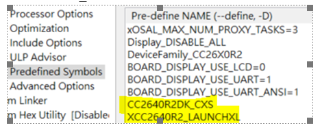

Then we added WCSP configuration to test on launchpad DIO4 (Connect DIO4 to GND to pull low then reset).
But it always enter PTM mode, not able to SWITCH mode via DIO4 as expected.
Any idea how to let it work on WCSP package and verified on launchpad?
CODE:

  • Hi Aichi,
    For sanity, could you please confirm using the debugger to check whether the GPIO_read() function executed in the code snippet you have shared always returns 0?
    Assuming the GPIO_read() function always returns 0, please verify the configuration of the GPIO and the hardware design on this pin.
